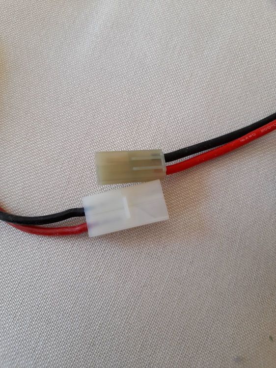

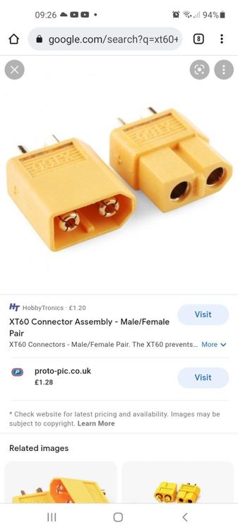

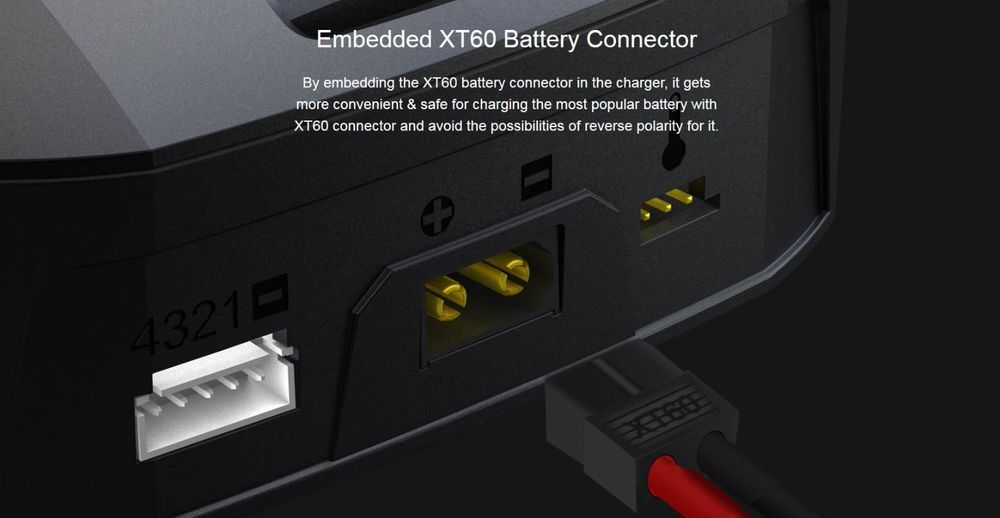

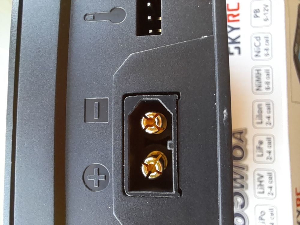

1st picture is my battery connecter,mini tamiya male so i need a female.2nd picture my battery connector next to standard tamiya so defenitly mini.5th piture charger box says female. But does it mean you "need" a female?.3rd shows my charger socket.4th is difference between male and female xt60 ,so going by the 4th picture then the sky connectorcis male and i need a female xt60?im confused now.20220805_092139.thumb.jpg.e7de3724b94593675776f056be6492d9.jpg20220805_092203.thumb.jpg.0b392563d3ec68dab47357a10a3eddd6.jpg20220805_092402.thumb.jpg.ca9c4d96708cf694cdbaa1cb0312ad0b.jpgScreenshot_20220805-092623_Chrome.thumb.jpg.3fd895bd2b8acfdfdaceab8dccf3bab7.jpg20220805_092313.thumb.jpg.be3710fc410277111a9aef7ee4e9ed76.jpg

No, the connector of the sky charger is xt60 MALE and your battery cable is mini tamiya female, so you need an xt60 FEmale to mini tamiya male cable.
(I get why its confusing because they both have male/female aspects, but it's the outer plastic part rather than the inner pins that define whether it's male or female)
