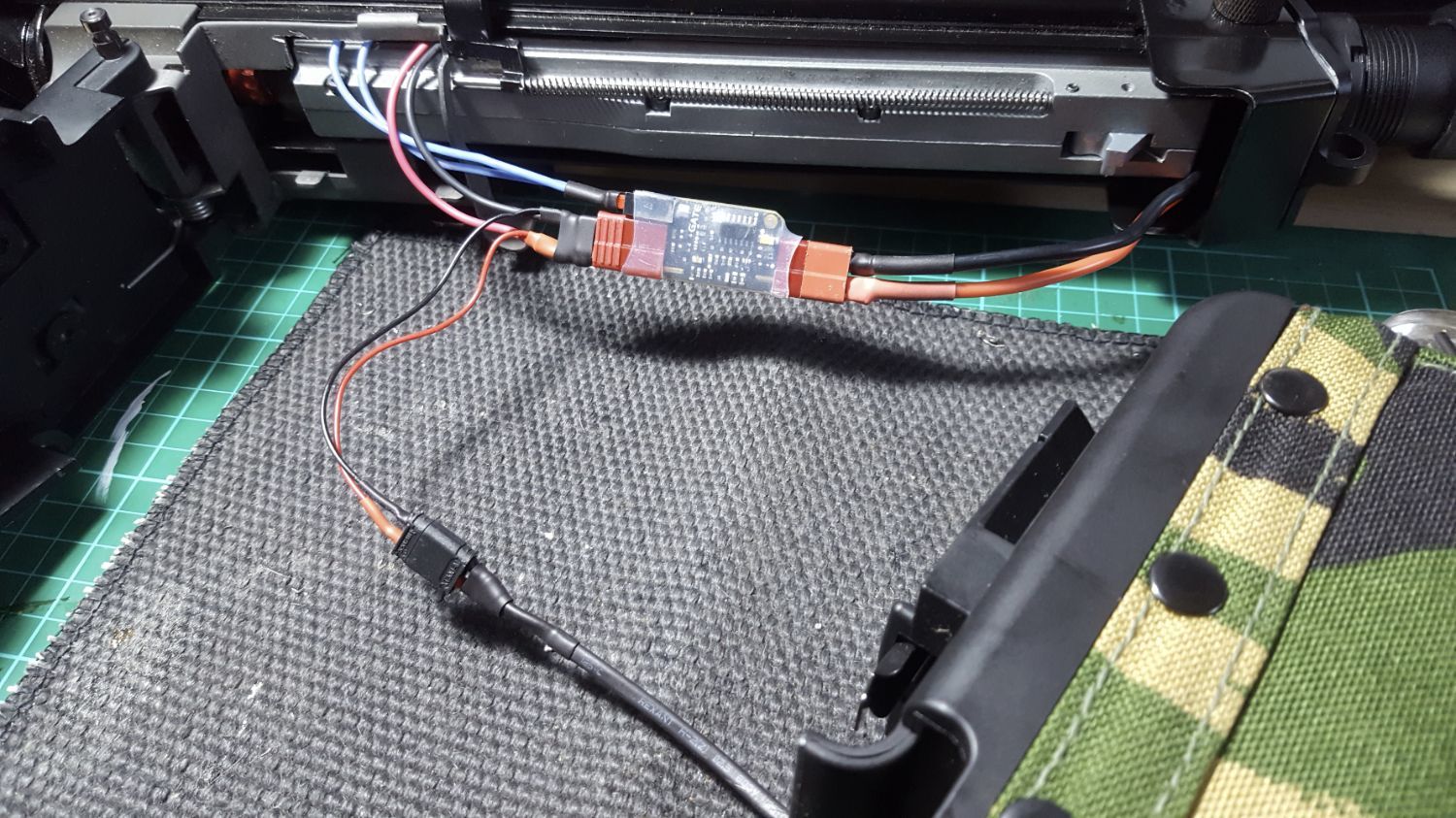

I've had the Nano Hard in a CA M249. It's very easy to do, just solder the trigger wires to the switch (in blue below) and plug them in to the mosfet. Set of wires go to the battery, set to the motor and you can split off the ones to the motor so you can drive the box mag when you fire. Mosfet has room to sit on top of the gearbox as long as you're careful when you close it up. Also gives you the option to swap out for a different gate mosfet if you prefer (other than the NANO asr because it's not wired the same)
