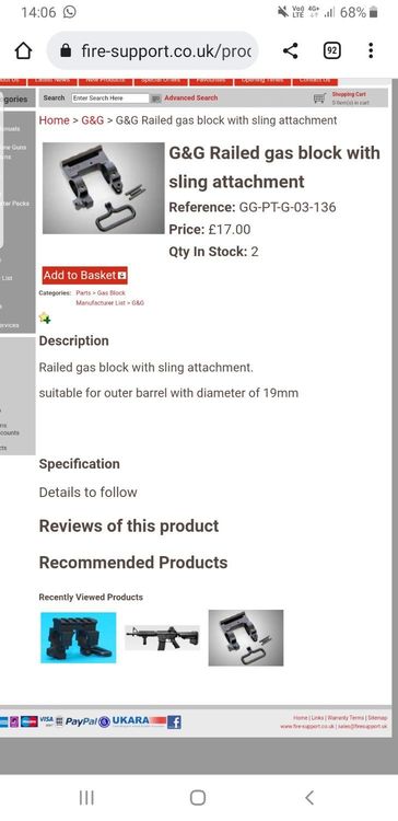

Thanks for the reply.
Would this be ok? I assume they are all a set size?

In all seriousness though, while that's a dangerous assumption to make with ANY airsoft parts, that bit should work but don't be surprised if it doesn't. You could replace the handguard with a free float style one and then you're just looking at whether or not you want a dummy gas block.

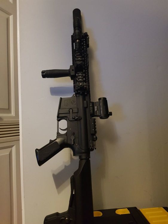

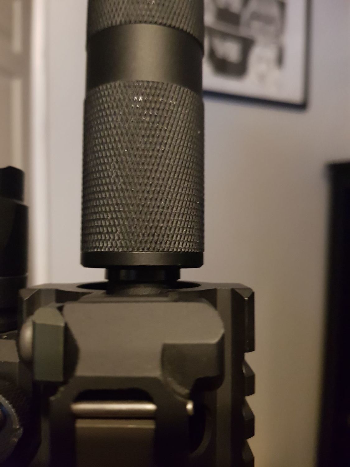

I did it with my specna arms mk18 rail.
It fits well, barrel is slightly off centre to one side but not a huge amount
 Going to test fire tomorrow and see how it shoots then possibly tinker with some shimming
