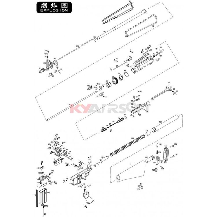

Still having problems with the VN.
To recap. Whilst shooting in a game a round got jammed under the hop rubber between the two halves. The loading arm at the end of the nozzle snapped sonit would no longer collect a round fro the magazine.
Replacent nozzle ordered and fitted. Hop unit removed and all debris removed. All fitted back together and it just won't go into battery properly. It's about 1mm too far back.
Now I have since realised that it is fitted with an angry gun steel bolt carrier and was fitted with an angry gun nozzle. (Purchased second hand so didn't know the difference) The we nozzle is a little tight inside the bolt carrier. Are the two cross compatible?
Angry gun nozzles for WE are known to have the issues. Not sure about the bolt carrier.
To be fair it was working well until it failed, never skipped a beat. Then it jammed giving the real immersive nam experience. I need to figure out what is happening and why it won't fully go into battery. I think the next step is remove the hop unit and barrel and try the fit of the bolt carrier outside of the gun.
