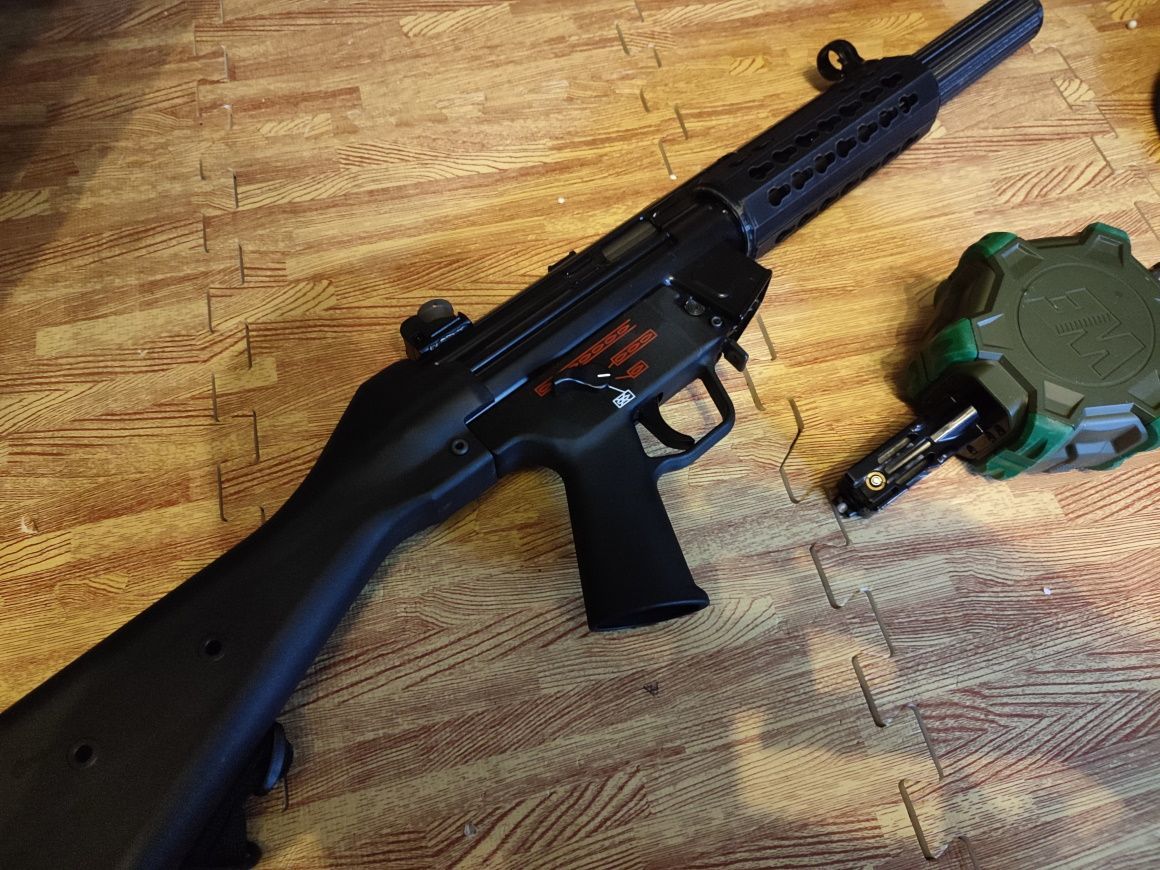

I can wholeheartedly recommend the Apache for a GBB SMG.
Been my go to for the past year. One quibble I did have was that for hop adjustment you have to remove the handguard and suppressor, but once set it hasn't moved since.
The upgrades I've done are a maple leaf green hop rubber and crazy jet barrel., and by god, this thing can reach out and hit someone from a very good distance!
The crazy jet barrel is shorter than the standard barrel so I made my own suppressors for it.
All the internals are still in really good condition, so hopefully will do for a good while yet.

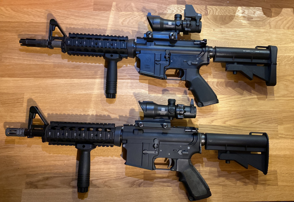

L119 A1 short (the top one is mine) and A2 long build in progress.
Both have stock hop with Maple leaf rubber and omega nub fitted and Crazy jet barrels. The A1 has an RAtec NPAS but the A2 is a DMR so runs unfettered. The A1 has RA tec internals in the trigger box but not due to any failures just that I had them and decided to fit them. The A1 has had a lot of use with typically 1000 / 1200 rounds through it on a game day and loads in the garden. No failures of stock parts and both run red gas pretty much all year unless its a very hot day.
10 hours ago, SBoardley said:
@Nick G love the a1. Classic. The new “long” has yet to grow on me.
Yep I prefer the A1 to the A2 tbh, but I had the front spare after i swapped my aeg A2 to a short , so ....... 🤣

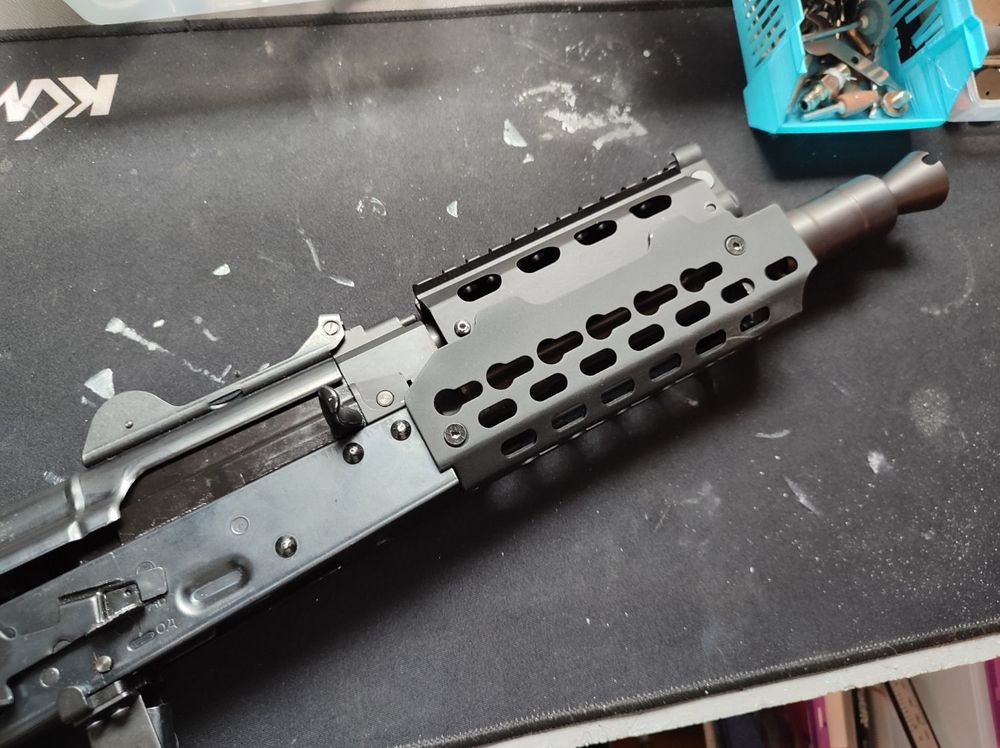

Anyone with an ak74su, and looking to fit a different handguard, the cyma keymod one fits, with a fair bit of dremelling.
The front of the top handguard still needs to either be drilled and secured to the bottom or adapted another way. It is a good tight friction fit, but I'm going to secure it down further.
The insides have to be widened to allow for the WE fitments, but all good in the end :)
