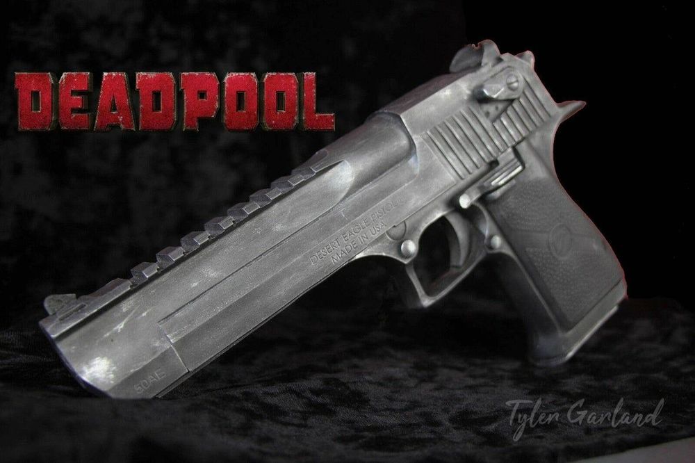

Sifu Steve Posted May 12 Share Posted May 12 (edited) Evening all. I'm hoping someone with experience of both versions of this gun can tell me the feasibility of my plan. Heads up, it's a bit niche. 😄 What I want: The full auto (metal slide) version, with a metal frame, with no under rail, that takes the full auto CO2 mags. The problems I have: I have 2 full auto versions with 10 mags. They have metal slides and plastic bodies, with a riveted under rail. I ordered two metal bodies which never came. What did come from that order was 1 green gas magazine... which doesn't fit the full autos. This has led me to believe that at least one metal frame is incompatible with my full auto slides. Is this the case? Why the **** am I doing this? Because I have a Deadpool cosplay and the holsters are sculpted to fit his Desert Eagles that have a railed barrel like the XIX but no under rail. I don't particularly want to drill the rail rivets out and would much prefer to replace the entire plastic frame with a metal one. Hopefully that makes sense. Apologies it's a bit specific but I was on the cusp of buying two full metal semi-auto versions, just for the frames, when that magazine mis-fit gave me pause. Included is a pic of DPs gun. I want that, but full auto, full metal, CO2 powered. Can it be done? Cheers in advance Edited May 12 by Sifu Steve Grammar - The difference between knowing your shit and not knowing you're shit. Tackle and Druid799 2 Link to comment Share on other sites More sharing options...
