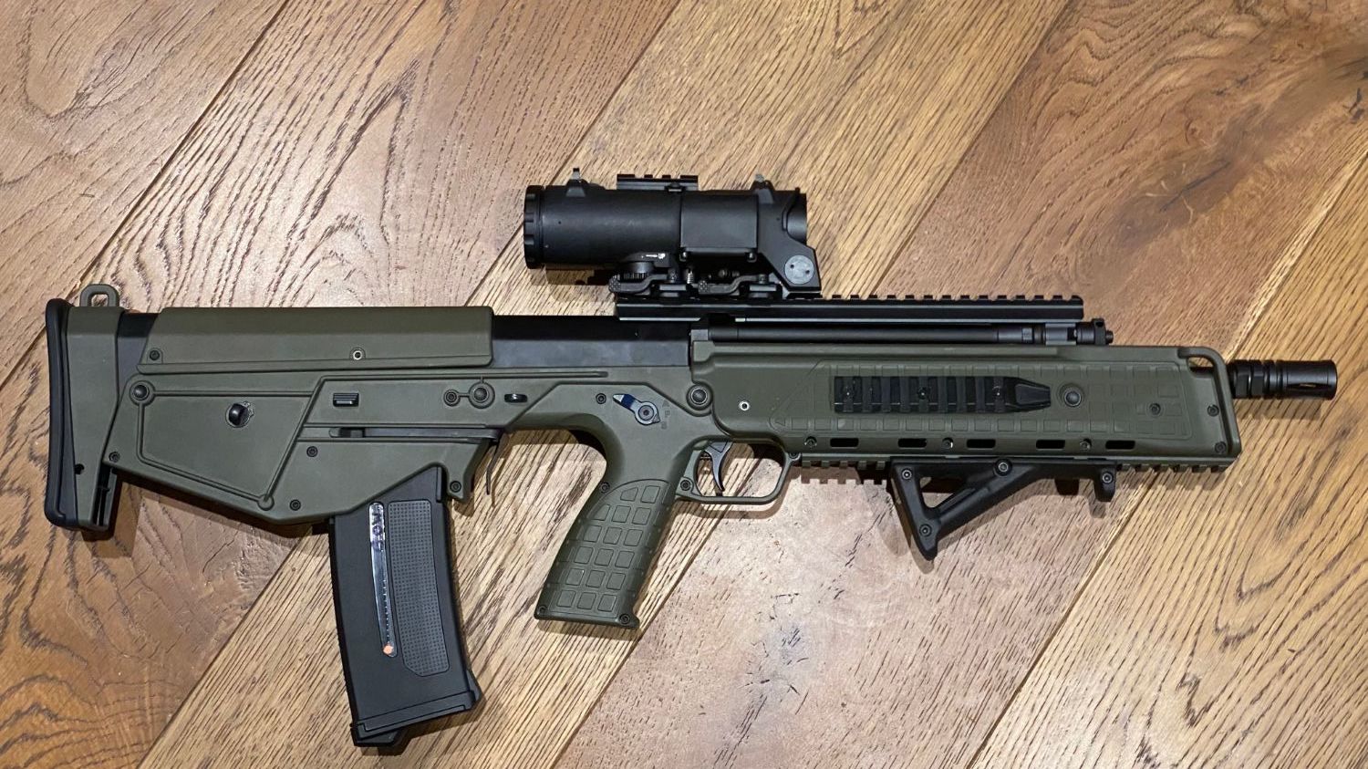

I played my first Airsoft game in November and was very quickly hooked. I originally wanted an SA80 rep but I was not overly happy with the fit and feel. I ended up with an Ares Keltec RDB as the balance, weight and fit into the shoulder felt excellent and very natural.

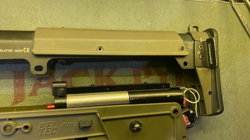

Since purchase I have made a few mods to it.
Piccatinny rails to the foregrip.

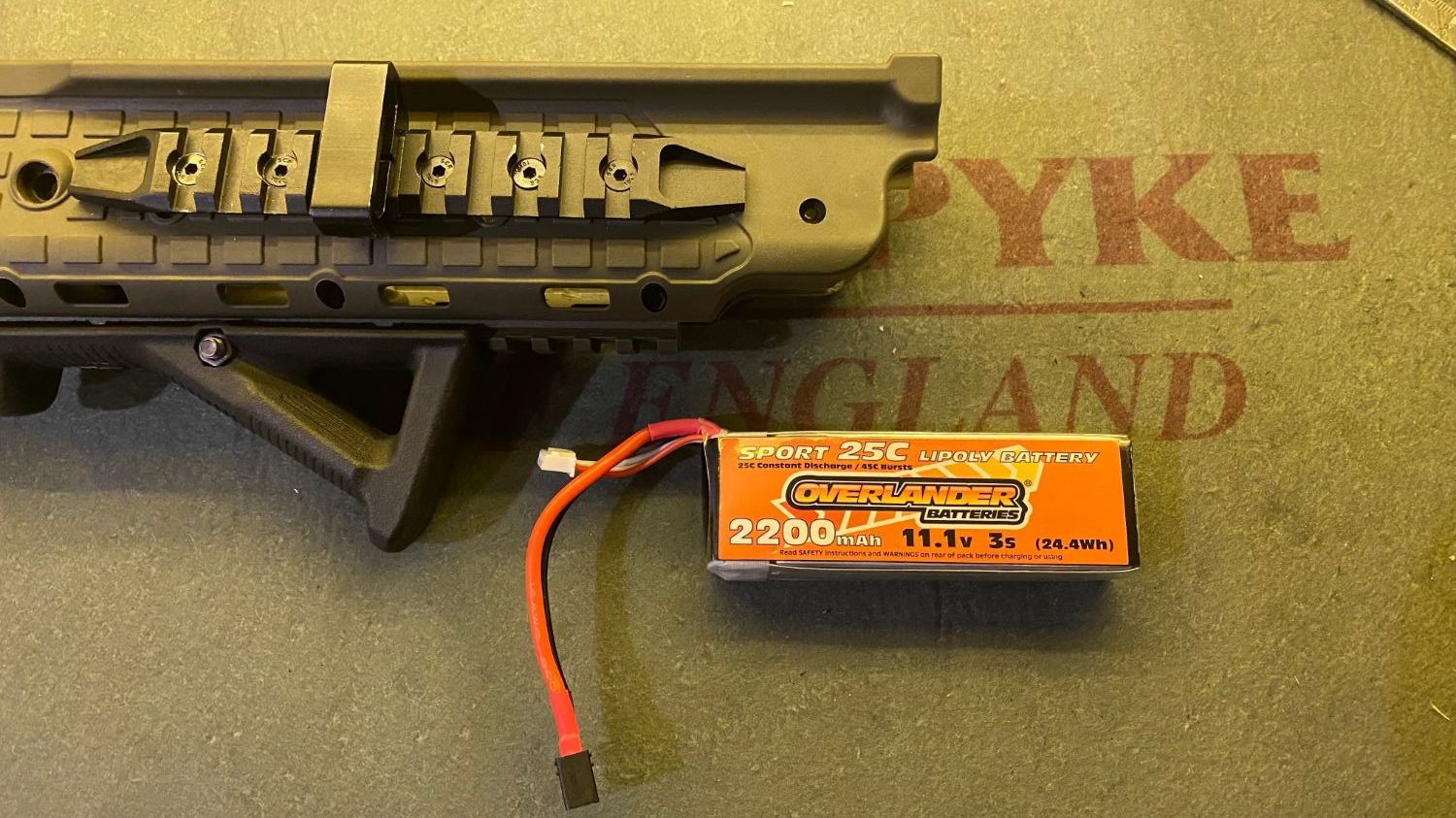

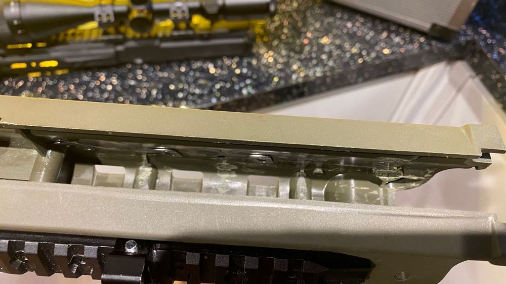

Dremelled out the inside of the foregrip to accept a bigger battery.
Fabricated and fitted a rear sling fixing so I could use an SA80 sling
SHS High Torque Motor
Maxx Pistonhead (waiting for delivery of a Max cylinder & cylinder head
Maxx nozzle
ZCI 6.02 barrel (taped to remove movement inside the outer barrel) and Purple Prom bucking
SHS M100 spring

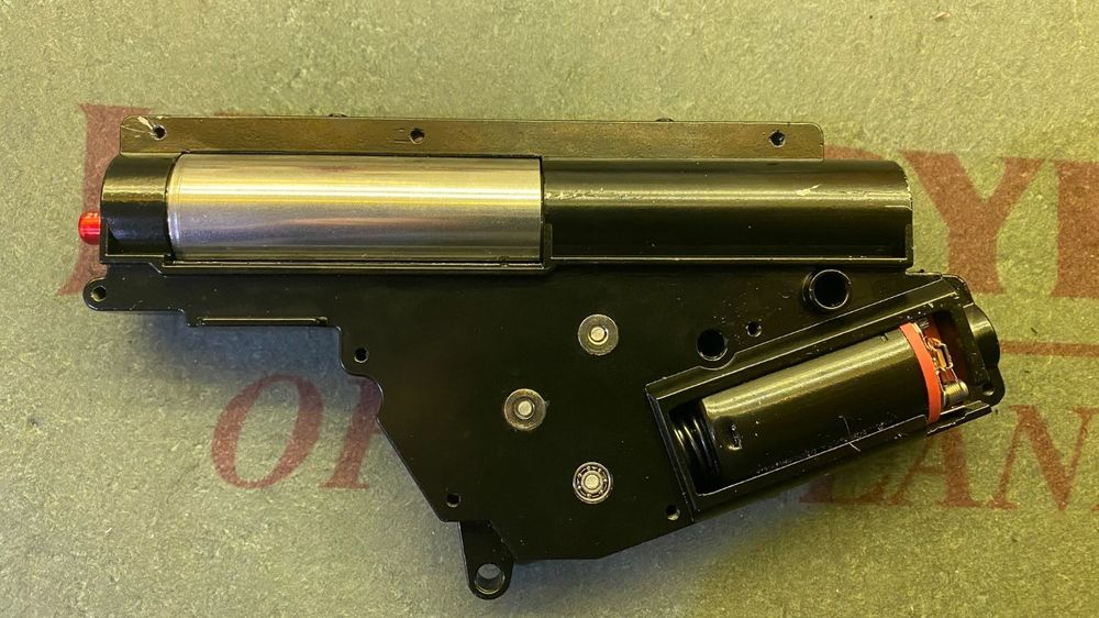

5 minutes ago, strykerles said:
that's an interesting looking gearbox. Do you have to put it back together with the motor in place?
Yes you do, it fits in a cage. Some of the ease of access with the gun could do with improvement. There is a mod to make access to the hop adjustment. I have done this to this gun and also my wifes. It helps a lot.
