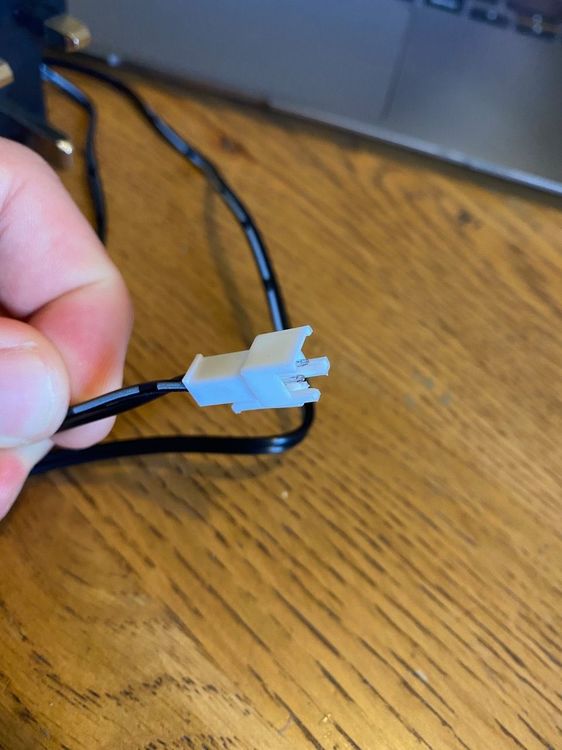

I purchased a CYMA AK-47 (022) for my son; and we've used it about 4 times since buying it - been about 6 weeks - and now it doesn't do anything. So its either the charger, the battery or the gun. I'm thinking its the charger... Airsoft World (where we purchased it from) sent another battery out - although its half the mAH rating and half the physical size; but it does seem to have the same custom connector (not a Tamiya-style one - big or small; its custom it seems). And my question is...
- Has anyone else had any problems with this type of charger / battery / gun?
- Does anyone have a charger that has the custom connector (square; two-pin) that these guns use that they're willing to part with?
Airsoft World basically aren't helping much more now... but I'd like to get it sorted.

The only connectors typically used in airsoft are the Tamiya ones you mentioned (either big or small), and Deans connectors which have two connectors arranged in a 'T' shape.
It sounds like you have the second type.   Does it look like one of these?
At the price you paid, I'd have expected a NiMH and a very simple wall socket charger with Tamiya connectors on gun/charger/battery, but it sounds like they've given you a new battery with Deans, or as you say a 'custom' type.

Please give us pics :)
It's unlikely that anybody here has one since they are - with apologies and no judgement on you - vendor trash and not suitable for anything except target plinking.  So we don't know what connector or battery or charger it comes with - I wouldn't even like to guess what voltage it's running at.
I'd be astonished if it's got a Deans connector, but as a wild guess, if it looks like this, that's the connector found on "gel blasters".
If you happen to have any other suitable batteries lying around, you could rewire the plug on the gun to match.

Its likely a problem with the low quality charger and battery but as Roger said, it may not be worth investing more money into that purchase unless you can try a different battery.
How are you at soldering?  If you can do basic soldering to change the plugs then its worth getting a Li-Po battery and charger to try because you'll also be able to use them with any other rifles you buy (assuming they fit)

On the charger front, I've attached some pictures; you'll see the connectors - and also the larger 700mah battery that came with the gun, then the 'replacement' I got sent that still doesn't make the gun work.... which leads me to thinking is the charger. I bought a multimeter and the batteries show voltage... the charger doesn't when plugged in - but not sure if thats only because it outputs stuff when something is pulling on in it.
I could solder a tamiya connector on both ends, locate a tamiya-style charger and do all of that... just 'should I'... is the question...

Looks like an old RC connector.  Doubt you'll find one to be honest.  Also those batteries have different chemistries, one is Ni-Cd (Nickel Cadmium) and the other is Ni-Mh (Nickel Metal Hydride) You could use the same charger but its not recommended as they would charge at different rates so the charge time would be different.

You really should get a 7.2v Li-Po battery and decent charger then fit Deans connectors to everything.  You'll be able to use that battery with any gun after that.

Tamiy and Mini-Tamiya can be fitted just with just cut-strip-and-crimping, no soldering required. I suspect that's one reason why they're still commonly used over Deans or XT-60.

See if you can find a fuse and check, replace, or bin it off.
If the batteries have charge, you should be able to hear some sort of response from the motor, even if it's just complaining.  Airsoft guns are also prone to locking up, where the spring is pulled almost all the way back but not released, then the motor lacks the startup torque to pull it the rest of the way.  When motors stall out like that they pull a lot of power, so you may be able to feel the wires, grip, and/or battery heating up if you pull the trigger - this is also a good way to pop the fuse or burn things out, so I wouldn't recommend doing much of it.
If it has locked up, you can (in an ideal wold) sort it with a freshly charged or higher voltage or C rated battery, or if not, have to disassemble it and manipulate the anti-reversal latch - I keep a bent kirby grip in my toolbox for this.  Sorry, I have no idea about the disassembly procedure for that model, although YouTube might provide some hints.  The unlocking should be something like this.
The other way to unlock a gearbox, which will have Reddit gasping in horror, is to get it apart far enough to access the gearbox nozzle, then shove a long Allan key or screwdriver up it and push the piston back yourself far enough so that it completes the cycle, being aware that it will then eject the tool forcibly, and you should of course never, ever try this (I've done it a few times).
The other possibility is simply a bad wiring connection somewhere, which you'll have to track-and-trace with your multimeter, starting at battery and motor ends and working towards the trigger.  If you do have a (plastic) V3 style gearbox then all to the best as trigger contacts tend to be external rather than internal. Again, YouTube will provide, you're looking for "V3 gearbox trigger contacts" or similar.
Sorry to be so long winded and vague, most airsoft gun issues are easy to fix, but take some time to diagnose, and are tricky to guess remotely without actually going hands on.
If you're intending to stick with airsoft, you might want to view the CM.022 as a cheap way to learn some teching.  Many of us have a project gun that we keep around just for tinkering and larks.
