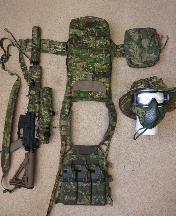

I run my MTW with plate carrier and big hydration pouch on the back for the 48 tank, but also have the fake foam plates front and back, also a small 1KG plate at the front for counter balance.
I want to separate backpack and smaller chest rig for the really hot days
