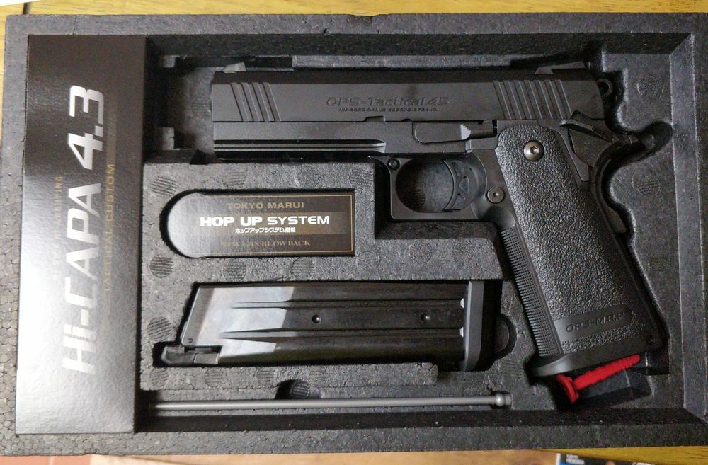

Absolutely stock from the box it was perfect and lovely! Just look at it!

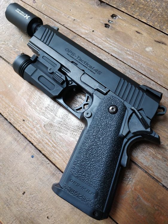

So a little run down of whats inside and out:
  • Nine ball 6.00 112.5mm / 5" Inner barrel
  • Maple Leaf 50 bucking
  • Standard Tokyo Marui Hop unit
  • Airsoft Masterpiece Hop Wheel
  • Airsoft Masterpiece Hop Arm
  • Maple Leaf I key  Removed due to over hopping 0.25's with no hop applied. Will probably try again now the bucking has worn in.
  • Makeit3D Tornado fixed threaded outer barrel
  • Cow Cow thread adapter / protector
So the above list was purchased with a two things in mind.
Firstly to allow the use of a tracer, hence the threaded outer barrel and secondly to up the FPS slightly.
The reason behind wanting an FPS boost was to lower the required PSI to achieve 300fps with my HPA MP5 mag adapter from Primary Airsoft.
The additional hop parts were purely because they were cheap and I was taking it to bits anyway.

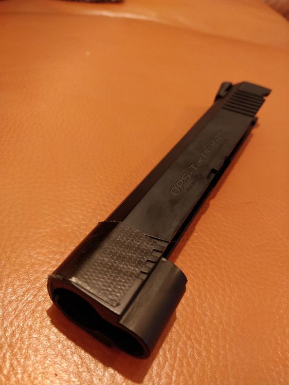

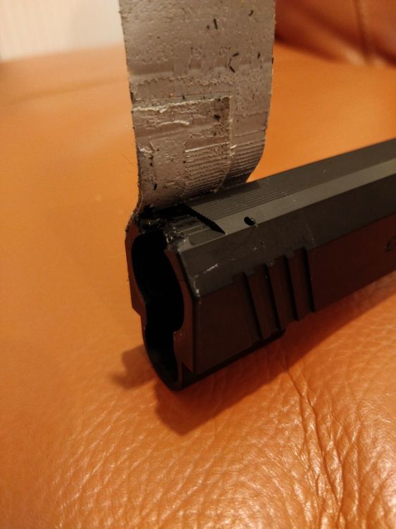

So the damage, crudely hidden under some gorilla tape for now.
IMG_20210928_223722.thumb.jpg.bd4be51752b6856e2902494ef2990110.jpgIMG_20210928_222318.thumb.jpg.736cd2f1720af5737cfaafbbff85b5f2.jpg
I was just chucking a few rounds down the garden when ping, I hear something hit the floor.
Look down to see my front sight on the deck and a chunk of my slide missing.
This probably has something to do with me not know a great deal about hi capa building but and throwing a Waldo recoil spring in. 130% and a plastic slide probably wasn't going to last very long!
I've since taken the Waldo spring out and put the stock TM one back in with a few soft short stroke rubbers.
I've left the waldo nozzle spring in at the moment. This is 150% I believe.

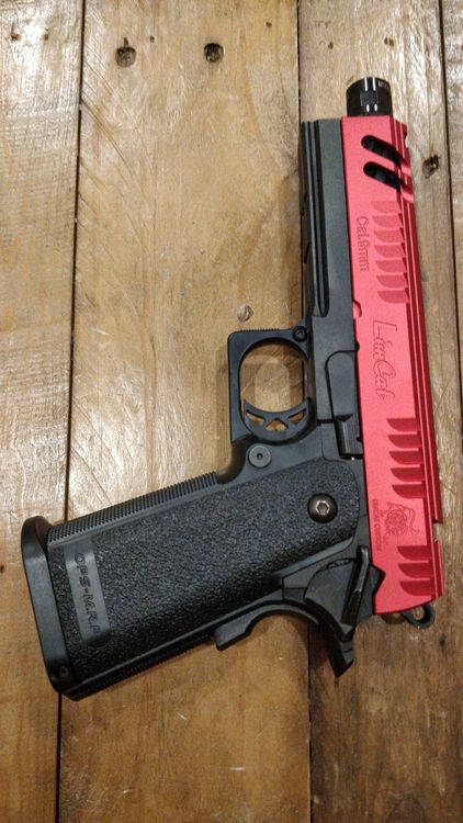

My 4.3 is currently still running the stock slide but with an AM BBU its lightning fast. When the Battlecat finally arrives, in a funny way it’ll be a downgrade
I was wrong about the other 4.3 STi slide I’m afraid. I had an image of it pre-anodising and the engraving was much more visible and the rebates less so. Still think it looks sexier in silver tho

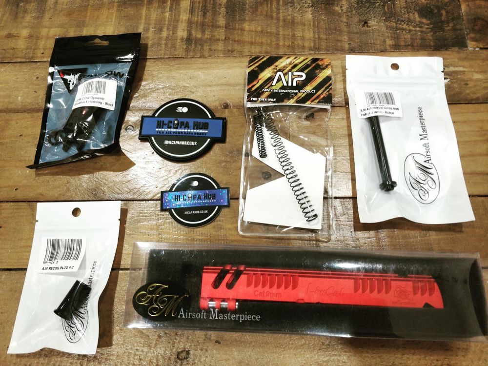

Well a short detour on the way home from work last night to see Kyle from Hi Capa Hub.
AM slide
AM Ali guide rod
AM Ali guide rod plug
AIP 120% Recoil spring
CowCow B01 blowback housing
I've also got some AIP sights and a trigger coming!
It's all @Steveocee fault!
Chucking in a red trigger to make it look less like I haven't got my UKARA yet! ?
Waiting for some.3D printed bits to come in. Hopefully a nice alternate slide for skirmishing and a magwell in black!
