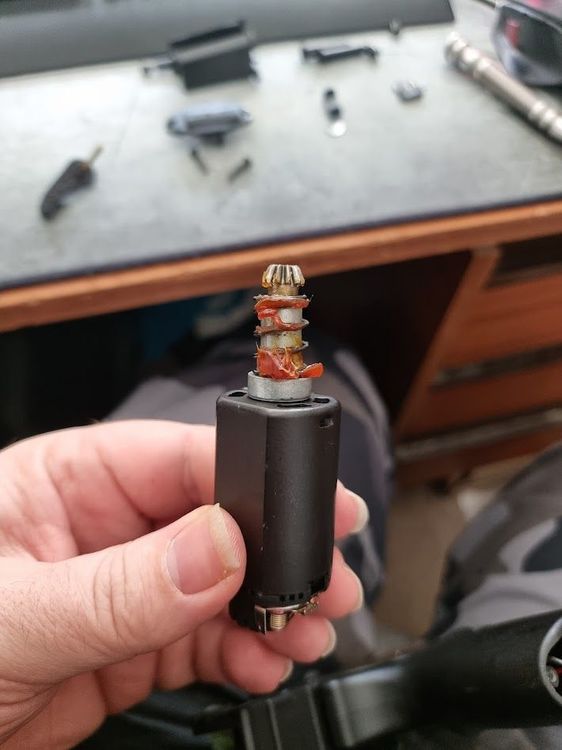

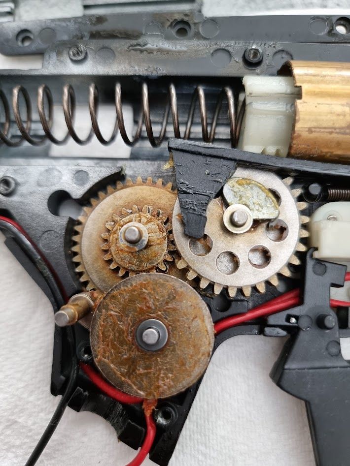

This is from my JG G3:

Looks like earwax to me!
