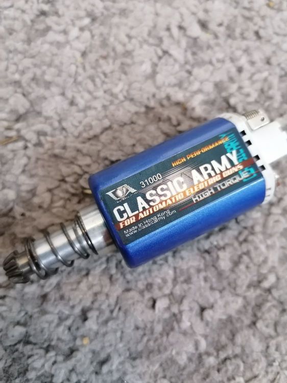

Pewpewpetie Posted August 5, 2021 Posted August 5, 2021 Hi just received my classic army scarab abr, having a slight problem with it. The motor (which Is the high torque version) is becoming very hot within 15 shots (be it on auto or semi). Is this going to be down to poor factory shimming/motor alignment?

Pewpewpetie Posted August 5, 2021 Author Posted August 5, 2021 2 hours ago, Lozart said: Wild stab in the dark, the mosfet your Scarab is fitted with has active braking. That'll do it. Literally just about to write that, I noticed sparking from motor after re shimming it and setting AOE. May sound stupid bit is there a way to remove active breaking or should I just get a mosfet without it.
