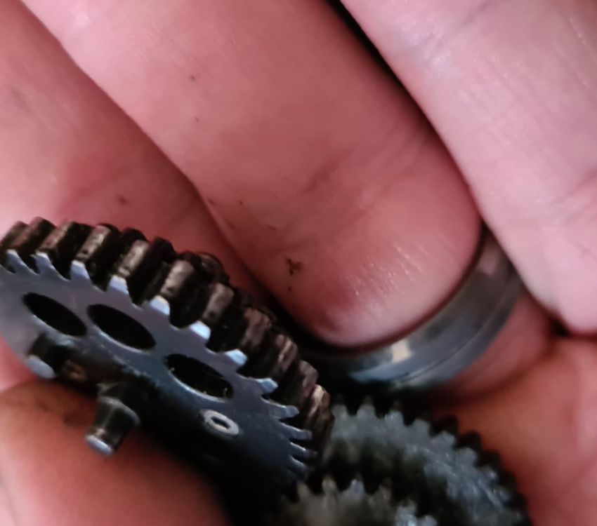

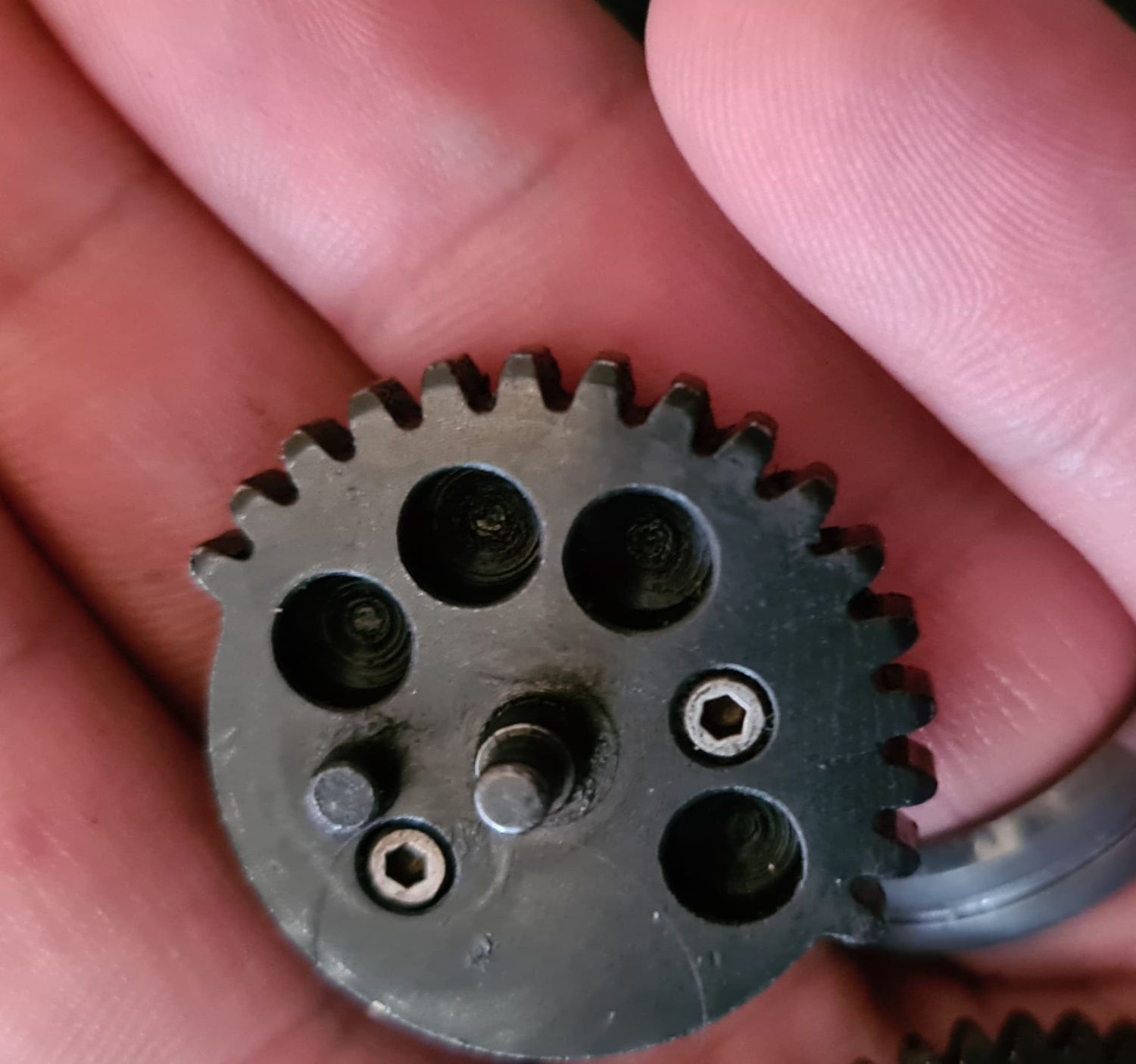

i dont think its pme as such i think its more the timing for the tappet plate as i get about 10-15 rounds then it happens clear the rif and off we go again.so i reckon i need to get a delay chip if i want to run the 13-1 gears in that set up i have reverted back to stock gears for now and seems to be spot on mag dumped full mag no issues no weird sounds etc
these are the 13-1 gears no excessive wear i can see forgot to get pic of piston
