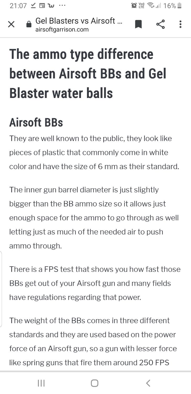

I'm looking to purchase a tm mk23 socom, 3 mags and a silverback suppressor. However I need to have it converted to a gel blaster. All of our xurrebt GBB pistols are airsoft conversions, 2011 TTI baba yaga, 1911, glock xtp, golden eagle 4.3, 5.1 etc. Gel blasters are essentially airsoft with different size and type of projectile/inner barrel diameter.(see attached files) I can provide the inner barrel to suit this conversion (7.3 I/D x 8.9 O/Dmm) plus gel balls for test firing. I do need a letter to submit to in line with my import permit stating the following:

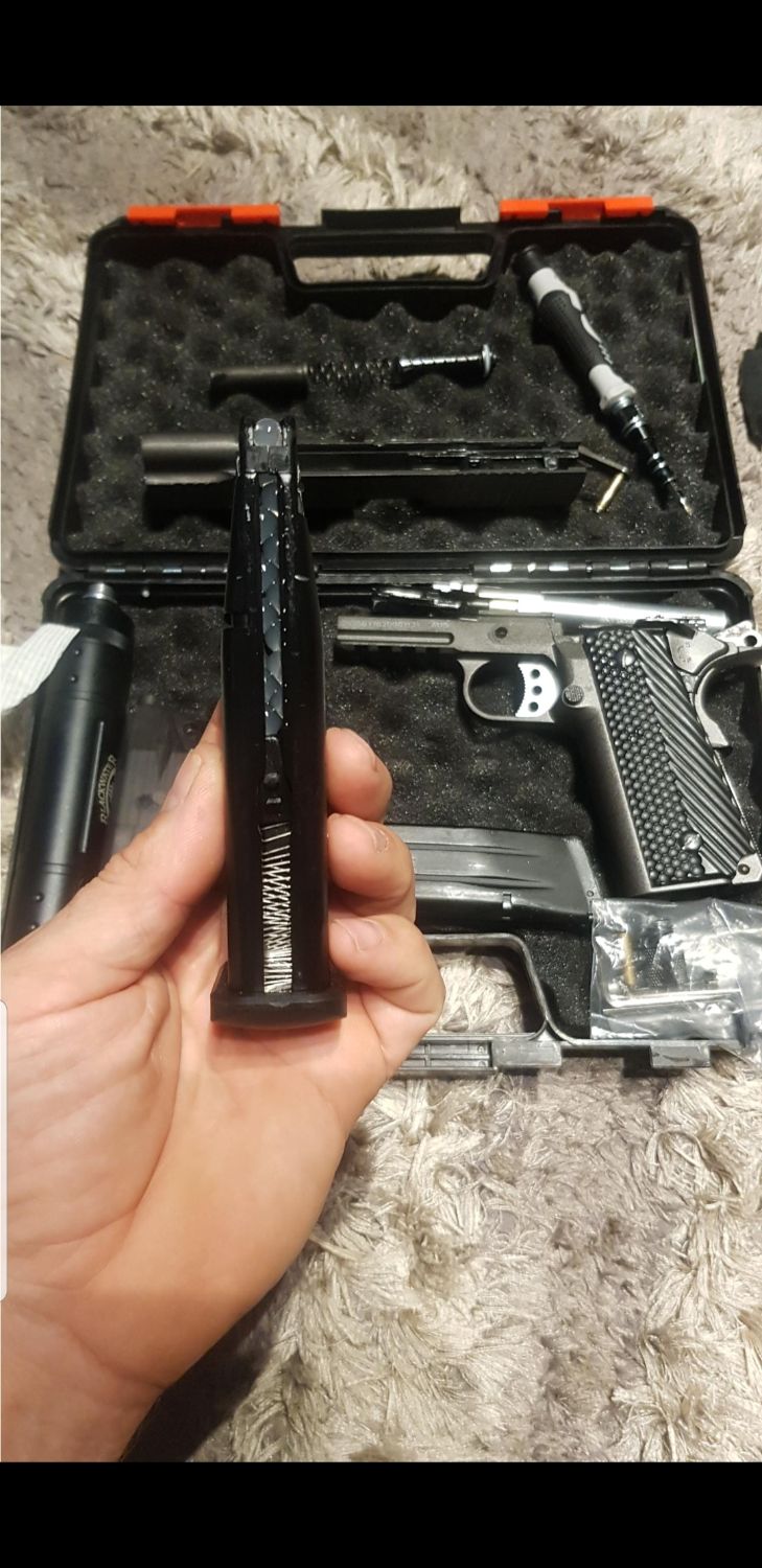

This is my 1911 gel GBB converted pistol.

I own a 1911 gel GBB pistol but I wasnt instrumental in its conversion. So I don't know the specific alterations that needed to occur to get it cycling properly.
I get that the 1/1.5mm circumference difference between projectiles might require some attention.
All things I'm happy to pay a technician money to iron out.

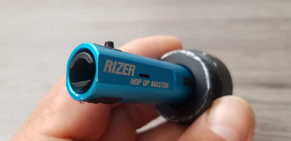

As pictured we do have hop up, but ours tend to go on the end of the barrel (see attached picture) I asked a gel blaster guru about the reasoning behind why we dont have the bucking/hop at the start of the barrel but i havent gotten a response.

interesting, in theory it would make more sense for the hop to stay at the start of the barrel, round is travelling slower so you're not getting an impact force. looks like quite a long unit though so maybe it's spread out to compensate.
technically having the whole barrel as a hop would be least damage to the projectiles but you need real consistency and a known ammo weight/energy to make that work (i vaguely recall someone mentioning something like that in paintball).
unfortunately curiosity aside i don't really know of any techs who'd match up the skill and the willingness to take on such a project, but maybe some folks in the community might have some better options than that. i don't know enough about the mk23 specifically to say what parts might need changed and wether fabricating replacements would be a viable option.
however if your dream is a mk23 esque theme then perhaps a converted usp? not quite the same thing in looks or performance but maybe close enough to cut the mustard given it's already known that standard gbb's can take a conversion.
The unit in the picture is about 50mm(2 inches) long, its grub screwed into place and i didnt really want to unscrew it and change its location on my barrel adaptor/suppressor base.
This model has two adjustments. A lower flat plate to adjust up or down to straighten the hop curve and a ridged upper curved plate that screws down or up to create the magnus effect/back spin. From my limited experience, its the better quality of hop ups for gel blasters.

yeah the contact patch looks to be a lot longer than the sub 10mm patch you see in airsoft, but then with harder bb's you can add pressure to compensate.

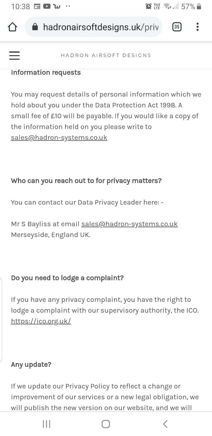

you need someone good at cad/3d print and knows mk23 . Hadron would be your best bet imo you wanted someone to take it on.
Try message on the Facebook
