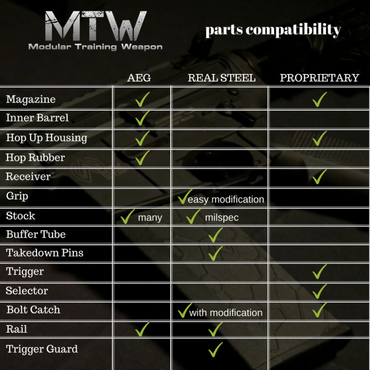

TLDR - Performance wise the MTW is the best RIF I've ever used, maintaince is very easy, but the tank and line will be an issue for some... alongside the price of both getting a HPA setup and the cost of the RIFs themselves.
I'll breakdown the engines first:
  • Inferno Gen 2 - Controlled by an FCU so needs a battery, programmable in terms of dwell, rate of fire. Operating pressure is 60-140 PSI.
  • Reaper Gen 2 - Being honest, I have no idea about the details of this engine. I personally see it as a choice between the Reaper M and the Inferno Gen 2 so have never looked into what the Reaper Gen 2 actually offers.
  • Reaper M - Mechanical so no battery needed, semi only. Operating pressure of 80-140 PSI.
They have 3 versions available:
  • 'Cheapest' The 'Billet series' which is the OG one, upper receiver is pretty much naked on the right hand side so no forward assist or dust cover. Comes with an M-lok rail (7", 10 and 13/14" options available), can be fitted with a variety of the engines and runs on the Spartan board (you adjust your FCU settings using the trigger). Comes with the original plastic black hop unit, engine retention clip and feed tube.
  • 'Middle Ground' The 'Milspec series' new release toward the tail end of last year. Conventional AR receivers so has the forward assist and dust cover (worth noting the dust cover doesn't close without modification).  Comes with a quad rail (10" only I believe)  and the Reaper M engine. Comes with the fancy Phoenix hop unit and an updated engine retention clip/feedtube (tldr, people kept breaking the old design of feedtube so they changed it on the new models, the Billet still uses the old one).
  • 'Big Bucks' The 'Forged series' new release toward the end of last year. Conventional AR receivers so has the forward assist and dust cover (worth noting the dust cover doesn't close without modification).  Comes with an M-lok rail (10" and 14" versions available) and the Inferno Gen 2 engine, runs on the Premium FCU board so a separate board with it's own buttons rather than having to program the FCU with the trigger. Comes with the fancy Phoenix hop unit and an updated engine retention clip/feedtube.
I've only used the Inferno Gen 2 personally, largely due to operating pressures and the fact I run mine at the standard limits rather than as a DMR (turns out I hate minimum engagement distances). On the various groups surrounding the platform I see far more issues with the Reaper engines than the Inferno ones, how much of that is user error and lack of research versus issues with the engines themselves I have no idea. I'll leave a chart below regard AEG/real steel parts compatibility. All this is very much a brief overview.
Worth noting that a variety of hop units can be installed on it, but require some modification to fit and hinder the ability to strip the RIF quickly. Entirely not worth it in my eyes, the stock plastic unit is fantastic. I haven't been able to test the Phoenix but reports seem to be that it's very good once you've taken the time to tune it properly.

I found myself in the decision of MWS versus MTW recently. I'm sticking with the MTW largely because of the drop off on return on investment for selling out of HPA is too severe a hit for me personally. Had that not been a factor I would have gone with the MWS, with the main reason being ditching the backpack (the tank and line don't themselves bother me at all, but I miss running a 'slick back'). The MTW has CO2 and tank stocks available, but something never mentioned with those two options is the restrictions they put on your length of pull. Not a big deal at all for many, but I've run my AR stocks at the same length for years... changing that feels decidedly weird and uncomfortable.
I also got lucky and snagged a backpack which is exactly what I've been after for carrying my tank on eBay, which cemented my decision for the time being. In case anyone wants to ask what it is, it's a Source 10L assault pack... they've been discontinued for a while (as far as I'm aware), hence the 'luck'.
TLDR - Following 'Any help spending (or saving) my money would be most welcome.' If you're not already invested in HPA, go with the MWS imo.

If you're running a tank and line whatever you go with I have a hard time not recommending a Billet series MTW. I've had two Billets and they've run great (both second hand), I picked up a Forged when they first came out because the quality of life changes seemed ace and I like having the 'proper' upper receiver. I can't recommend it though, not because I've had any issues thus far, just purely on the fact that Tier 3, Tier 4 and eventually lockdown happened so I haven't done any proper testing or played with it yet. I don't tend to give any recommendations/advice until I actually believe what I'm saying rather than allowing the 'hype' to overcome me.
Worth noting I have zero knowledge or experience regarding the Tippman, though I can tell you anecdotally that I've seen a fair few go from the Tippman to the MTW and at least in terms of performance the MTW seems to be seen as an upgrade. Take that as you will, as I say, anecdotal.

I expect the MWS would require more maintenance than an MTW, though the maintenance on both is very easy. MWS has the benefit of recoil, but you're somewhat restricted to a drum mag to run it with HPA. With appropriate hop tuning I imagine performance is pretty equivalent, the MTW possibly more consistent because of the nature of how the system works and the way alignment is maintained. The MWS would end up needing more things to be replaced over time, but nothing overly expensive. Main consideration there is supply given how impacted stock levels are at present.
That's about as much of a relatively informed comparison as I could give on those, though a decent portion of it is based on suspicions of using an HPA'd MWS formed from having used an MWS, and HPA... but never the two together.

Not that I’ve ever had to change any out but the main thing you’d likely need to swap out would be o-rings. I got a full replacement set with my Forged, can’t speak for the Billet as mine were both second hand. As for the electronics the most frequent thing I’ve seen need replacing is the switch which controls the selector, folks more competent than me solder a new micro switch on others replace the board entirely (no idea of the cost). Outside of those the only other thing which comes to mind is the feed tube for the Billet, I honestly have no idea how folks break them... but they do.
If you get a new one and you register it Wolverine have a warranty and they seem to ‘look after you’ pretty well assuming you haven’t gone out of your way to break something. Again, this is anecdotal, I haven’t had to replace or repair anything on mine.
If you want the ‘bolt stop’ (it’s literally just a micro switch, no tactile/mechanical feedback... very much intended for muscle memory training more than it is ‘simulation’) you’ll need to use the Wolverine mags (120 round mid caps) which are proprietary. If you don’t care about the ‘bolt stop’ then a bunch fit and feed. I’ve personally used the Wolverine ones, PTS EPMs and PTS Pmags. EPMs needed a bit of electrical tape to make them fit snug. Reports from others are that the EPM-1s fit and feed fine, most stating they fit better than the original EPMs... but I’m also aware the jury seems to be out on if the EPM-1s are actually any good and I’m not in a position where I particularly need/care to find out for myself.
