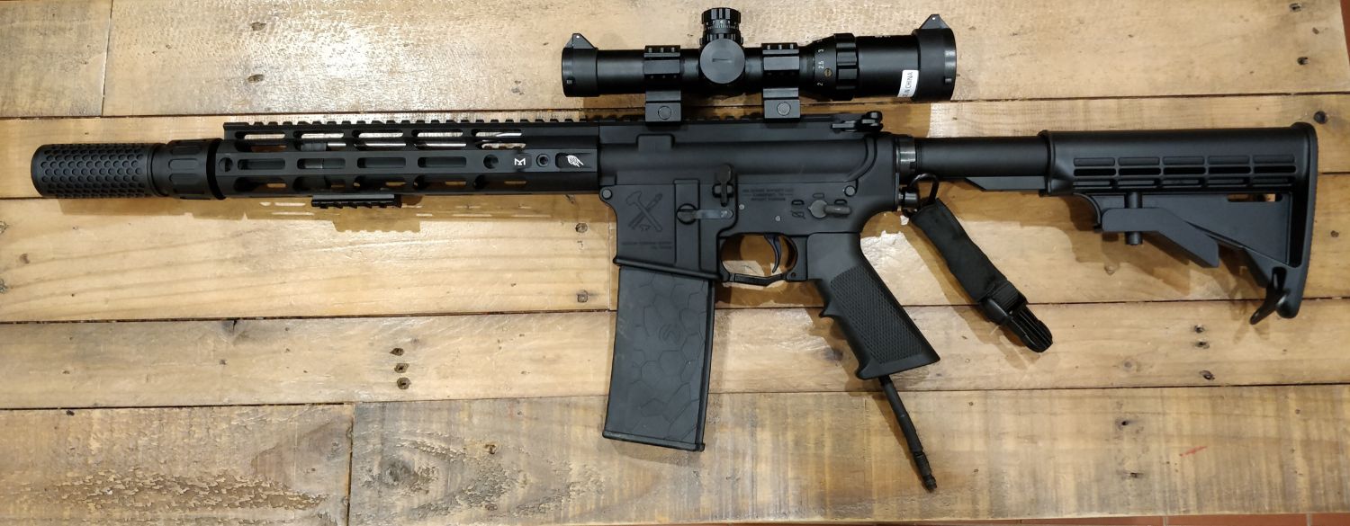

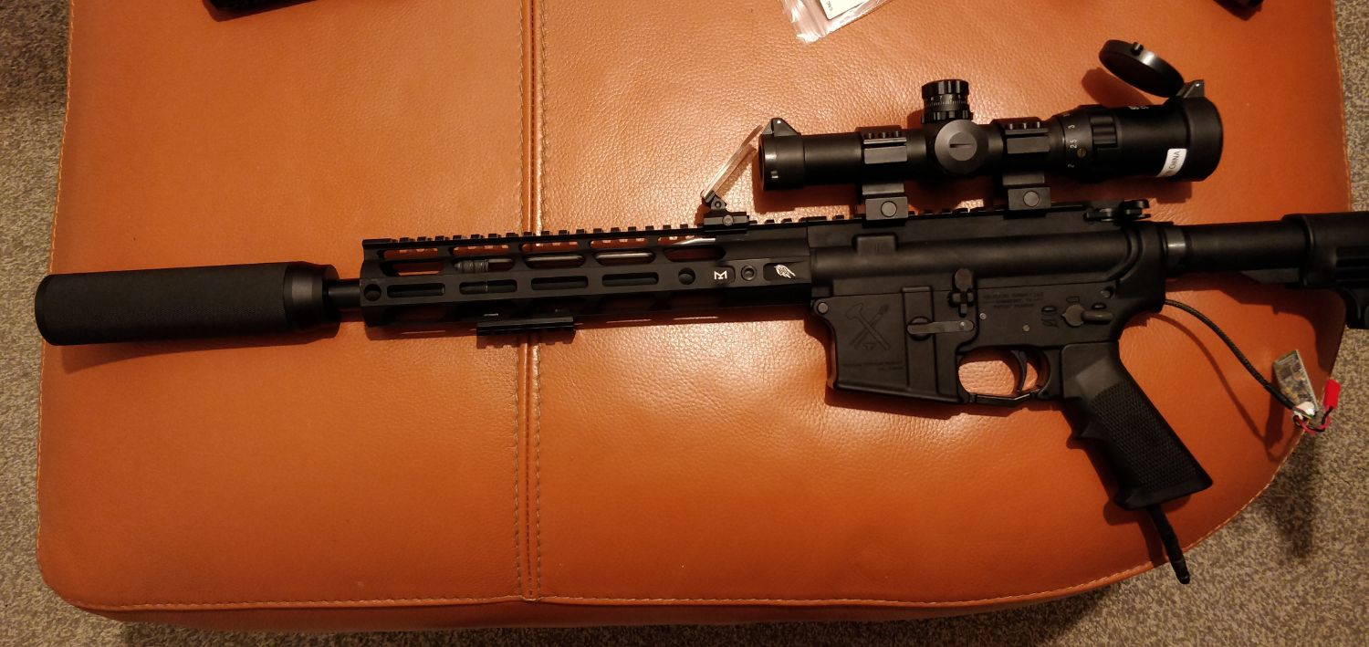

The above with an ASG Strike Short dot and QD KAC supressor
And then I spent £15 on a Lee's Precision Engineering adapter so I can fit my MK23 Silverback supressor.
Resulting in this...
Honestly, it's ridiculous how quiet it is now with that on!

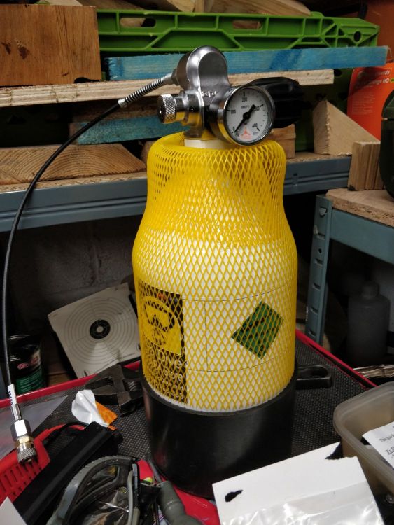

Oh and I also got a 3litre dive tank. Not the biggest I know but I only live 2 miles from Go-Dive who are still open. I wanted something I can easily carry and fit in my classic mini!

Btw..using the handpump is intresting... Once up to 2000psi it's quite a workout getting it to 3000psi.  :)

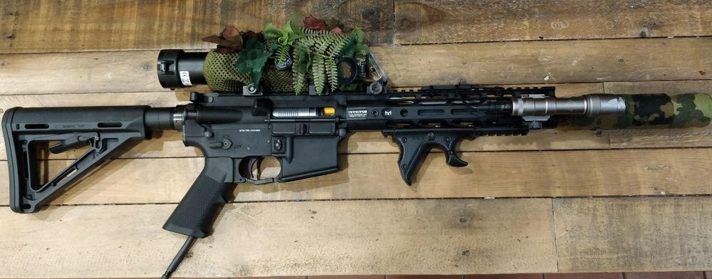

Got bush!?

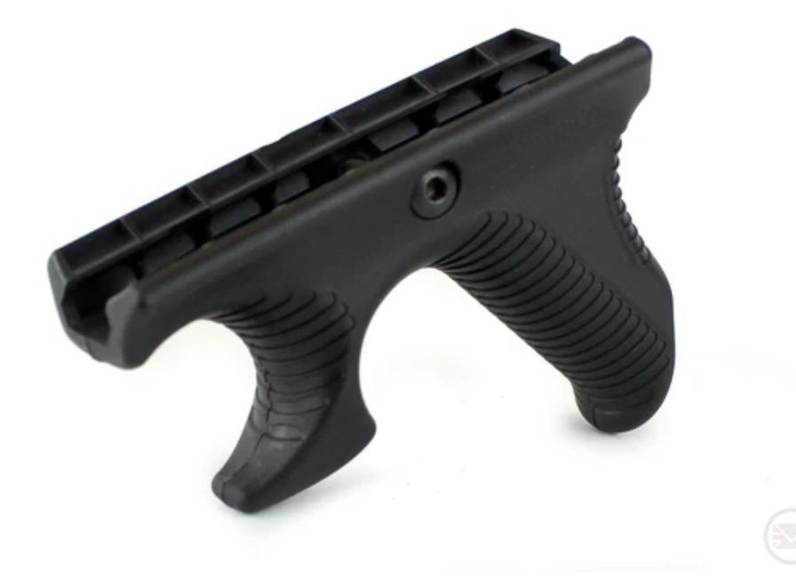

New Magpul stock and a Nightstrike Diamondback angled fore grip!
You can't really see it but it looks like this:
Very comfortable with a lot of different grip options!

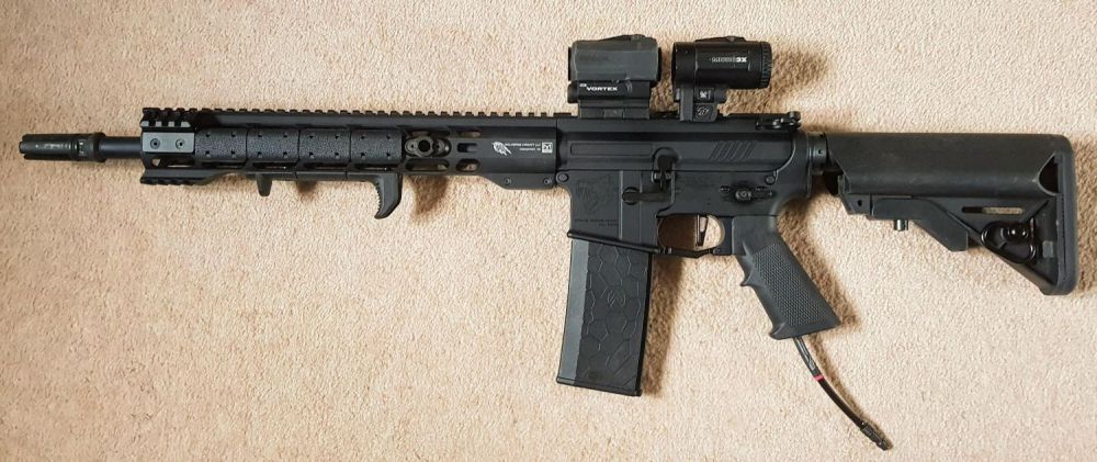

Well, courtesy of @alxndrhll the MTW now has a 285mm 6.05mm PDI barrel and silent industries 1.0 arm. Also have the 2.0 incase I want to try a different nub.
PIcked up a G&G green hop rubber from UKFOB last night as well.
Pumped half a mag through it last night just to check it fires correctly after putting it all together. Fuck me the hop rubber was tight to get in. Liberal use of silicone oil and then a through clean after helped get it in!
The nozzle got stuck a few times but came unstuck with another trigger pull. I assume it may stop happening once the hop rubber breaks in a little, I fill my tank up and increase the pressure to accommodate the wider bore barrel. If in doubt, adjust the feed lips about!

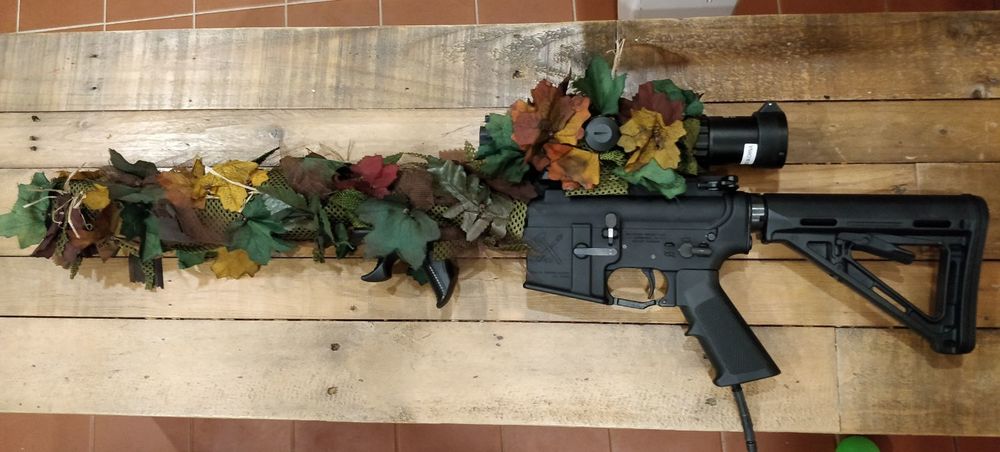

Took the leaf wrap off for Anzio on the 17th, mainly so I could run my flash light.
I'll still be going full bush man, but might have ordered a new Viper Gen 2 plate carrier at UKFOB while I was getting my bucking for those moments when the bush isn't needed. (New CQB site and Gaol mainly)
