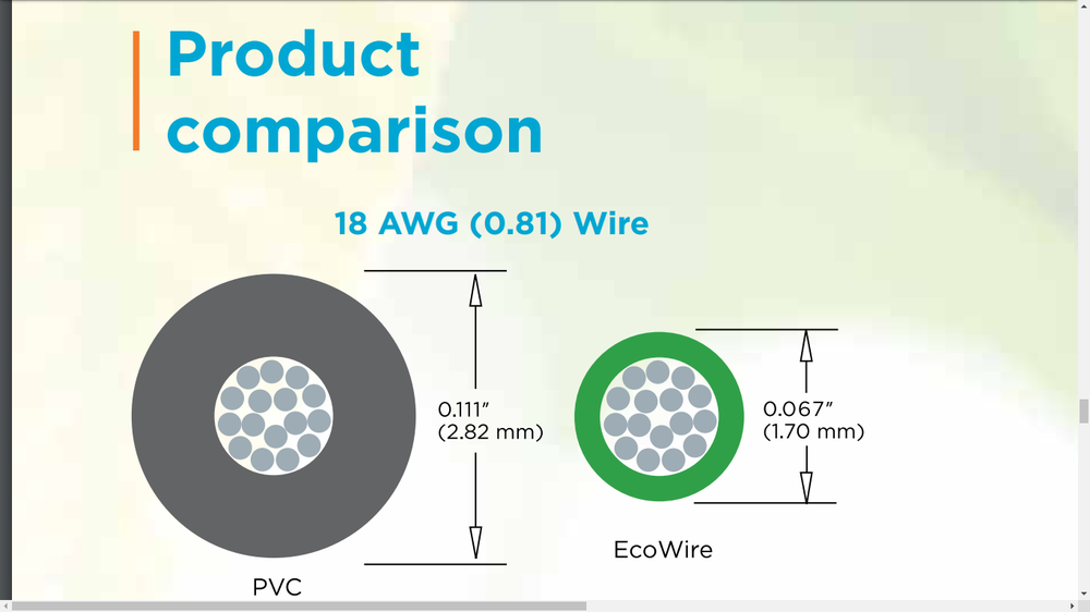

It is a tiny bit stiffer than regular wire but is due to thin but very robust nyrol/mPPE insulation
which means you get 3mm silicone wire in 2.1mm thick wire
(though to be honest some 16awg might have up to 30x.25 strands (specs do vary)
& Alpha is 26 x 0.25mm strands, so a whisker less than some high spec 16awg wire, but 16awg varies
but c'mon, if space is tight like in V2 channels, you get the spec without the grind(ing of channel etc...)
A word of advice - 14awg Alpha is fucking stiff, much stiffer than the 16awg
& I'd only ever consider it on ultra thirsty builds like a really really insane DSG for example - so go for 16awg imho
(the 14awg is a c*nt to work with if you need wire to bend in say a v2 pistol grip, but 16awg is perfect)
an idea of how it compares - 18awg example...

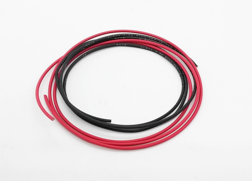

thanks chaps, I'll give it a go.  have ordered a couple of rolls and will put it onto the website.  I'll do a test / comparison video when my other stuff arrives as well
Got some 2 metre packs (red and black) on the website now, it's definitely less flexible than the ptfe insulated 16awg wire but that can also be a good thing, it's certainly improved since I last tried it - impressed with it for the price.  Thanks for the suggestion.
