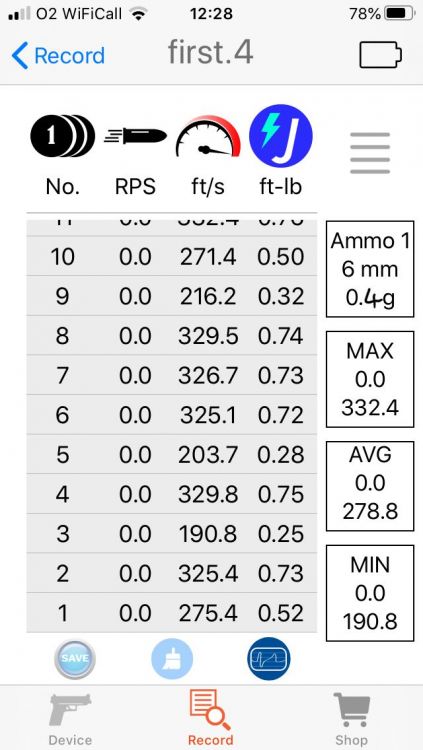

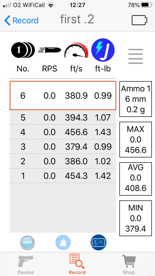

MiK Posted September 6, 2020 Author Share Posted September 6, 2020 Ok done the install - wasn’t as scary as I thought it would be - just really took my time. I did some Chrono on .2’s and .4’s I haven’t adjusted the hop yet - just wanted to see what was what - there’s some variation in FPS tho ( I had changed to .4’s on the chrono just forgot to change it on the app but the numbers match the chrono) with the variations is that a air leak or just a bedding in thing ? Also the mags a little stiff getting it in - any reasons for that ? Link to comment Share on other sites More sharing options...
Hudson Posted September 6, 2020 Share Posted September 6, 2020 No, it shouldn't vary by more than a few FPS really, so there must be a leak somewhere. I'd check the piston & cylinder section first. Unscrew the outer barrel and take the trigger, receiver & cylinder. Cock it it, then cover up the cylinder head with your thumb or something. The piston should stop partway if your seal is good, but if not it'll release all the way. If it's bad, fix that then try again until sorted, reassemble & re-chrono to test the consistency. If the air seal is good but you're still getting a wide range then look at the hop unit and barrel to fix any leaks there. Link to comment Share on other sites More sharing options...

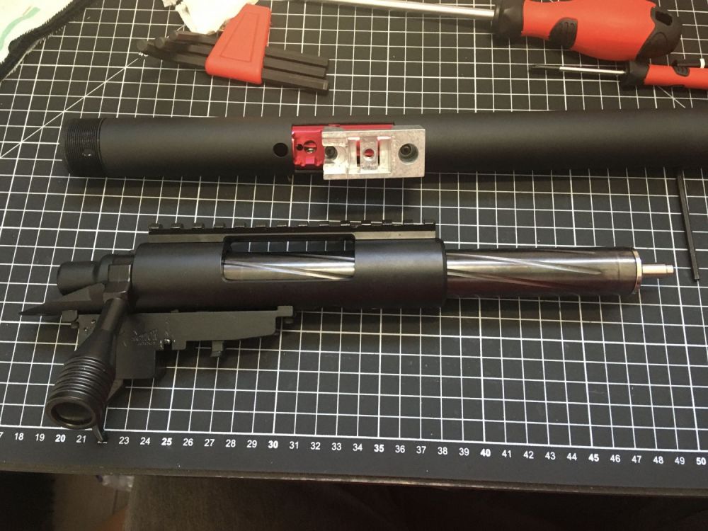

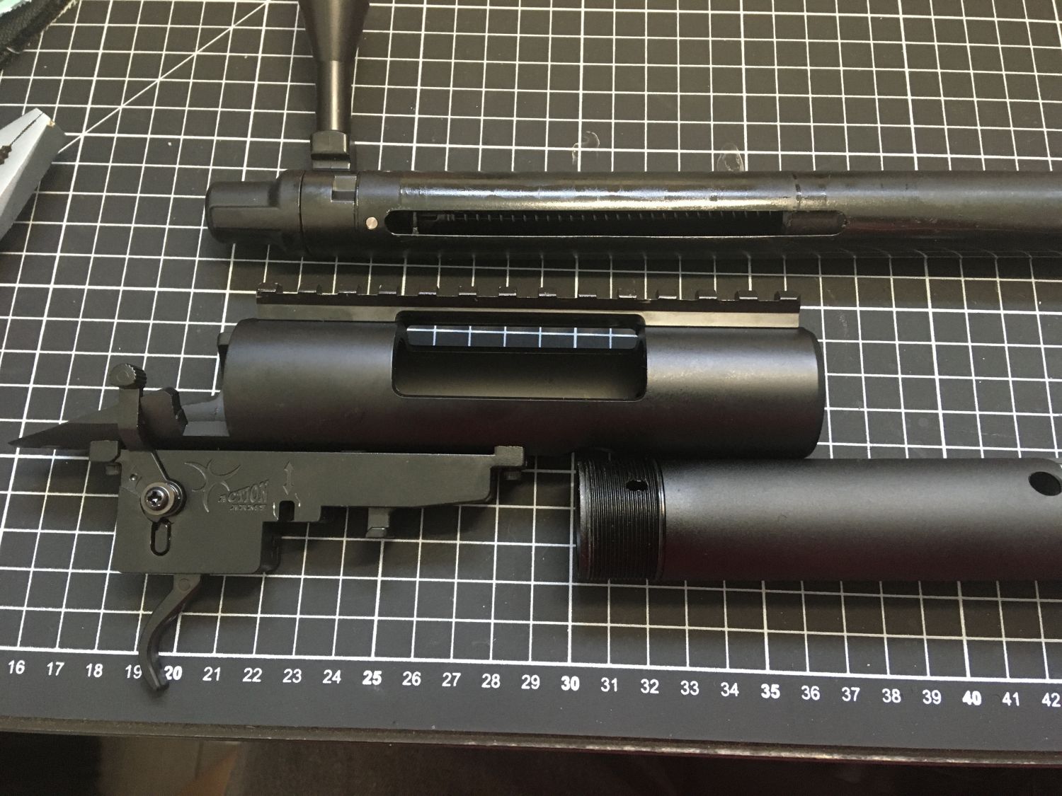

MiK Posted September 6, 2020 Author Share Posted September 6, 2020 @Hudson Ok I striped that down to trigger/upper/cylinder when I fire I can hear a kind of “faint bubbling” inside of the cylinder - sounds like air is coming out of the middle/back of the cylinder nothing seems to be coming from the nozzle Link to comment Share on other sites More sharing options...
MiK Posted September 6, 2020 Author Share Posted September 6, 2020 @Hudson All sorted !! After stripping it all down and remember that white peg I was asking about yesterday ?? Well it wasn’t tight enough got that sorted had a nice seal and was firing around the 460-465 mark then I tweaked the hop-up a little and it went 472-475 - don’t have any screenies as I did a firmware update when it popped up and I lost everything and now it’s tipping it down so can’t get back out. But if it’s nice tomorrow evening I’ll try again and get some numbers for both .2 and .4 /cheers for the pointers Link to comment Share on other sites More sharing options...
