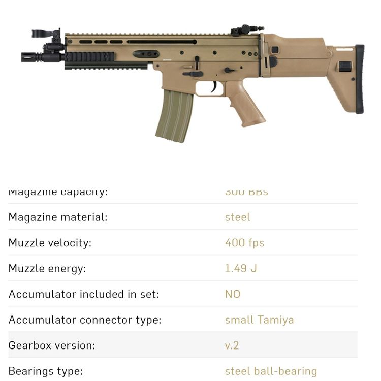

SgtDABS Posted May 9, 2020 Posted May 9, 2020 So basicly I have a double bell scar it uses the army armament gearbox according to the book my one is making a loud screaching vibraiting nice from gearbox or motor I have no idea how to begin to work on this as only used a pistol before when tecing . Dose anyone know a gearbox that will fit straight in to the gun as is I have taken motor out it defently works . It was working fine was shooting in back garden and put one mag thro it then it's just what I can assume as jamed badly please help
BigStew Posted May 9, 2020 Posted May 9, 2020 Screeching generally means the motor height is off there should be a grub screw in the pistol grip to adjust the height. that would be the first point of call. when testing tighten the motor all the way up before testing and bring it down unitl you get a good engagement noise. hopefully the gears haven't been damaged.
Scottish m3ch Posted May 9, 2020 Posted May 9, 2020 4 minutes ago, BigStew said: Screeching generally means the motor height is off there should be a grub screw in the pistol grip to adjust the height. that would be the first point of call. when testing tighten the motor all the way up before testing and bring it down unitl you get a good engagement noise. hopefully the gears haven't been So slowly start losing after fully tightened as as it is it's just sounding horrible
BigStew Posted May 9, 2020 Posted May 9, 2020 so it should go from not being able to turn to standard firing. if that's not working a gear is probably stripped. how does the motor pinon gear look? if the gears are stripped you have the most common gear box in airsoft a version 2. you could try repairing it there are a tonne of videos on these gear boxes. Negative airsoft is good. or you can just buy a new complete gear box.
Scottish m3ch Posted May 9, 2020 Posted May 9, 2020 1 minute ago, BigStew said: so it should go from not being able to turn to standard firing. if that's not working a gear is probably stripped. how does the motor pinon gear look? if the gears are stripped you have the most common gear box in airsoft a version 2. you could try repairing it there are a tonne of videos on these gear boxes. Negative airsoft is good. or you can just buy a new complete gear box. I've heard that thay have modified gesrboxses to the standard g2 same as my aug it's a gen 2 but difrint ahah
BigStew Posted May 9, 2020 Posted May 9, 2020 Aug is not a Version 2. he bell is a clone of a JG which is a clone of a classic army so should just be a standard V2.
Scottish m3ch Posted May 9, 2020 Posted May 9, 2020 11 minutes ago, BigStew said: Aug is not a Version 2. he bell is a clone of a JG which is a clone of a classic army so should just be a standard V2. I thought it was my bad Its same as ak with a difrince
BigStew Posted May 9, 2020 Posted May 9, 2020 yeah they have different trigger block on the version 3

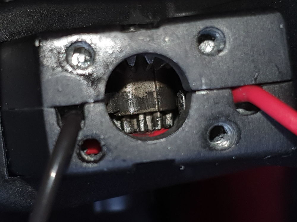

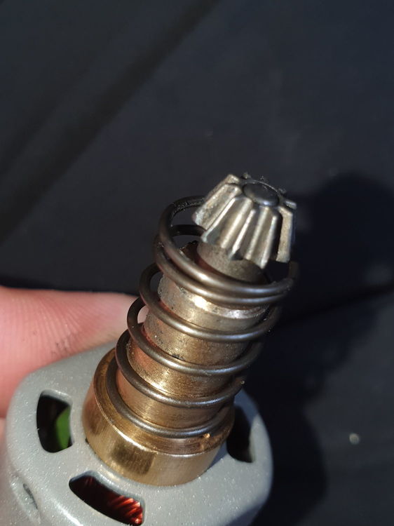

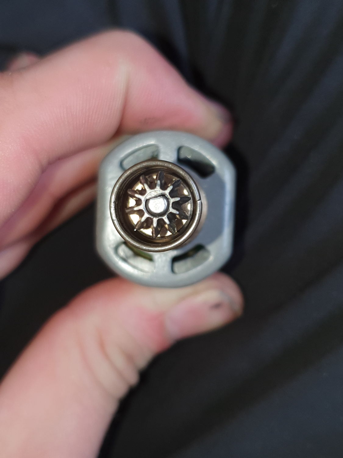

SgtDABS Posted May 10, 2020 Author Posted May 10, 2020 @BigStew not having much luck and dont wont to brake it any tips allso I have attached some photos of what I can see from ware the motor connects and the motter head for you to have a wee look and see if thay look striped or not I think thare fine but I dont k ow what should look like
BigStew Posted May 10, 2020 Posted May 10, 2020 from what i can see doesn't appear to be any excessive wear on the teeth. If it's not the motor height you are going to have to open it up.
Scottish m3ch Posted May 10, 2020 Posted May 10, 2020 3 minutes ago, BigStew said: from what i can see doesn't appear to be any excessive wear on the teeth. If it's not the motor height you are going to have to open it up. Have tryed tigiting whole way to puting it lose to point can spin with fingers and no joy I'd pribubly rather buy a new gearbox and try work on the old one than brake the whole thing

Skara Posted May 10, 2020 Posted May 10, 2020 It's always a gamble with low cost stuff. You mentioned a new box but with the gun being cheap (hold on, I'm not bashing you for buying cheap, not everyone can afford a TM recoil as his first gun), my guess is that it may not properly fit as low cost stuff may have different quotes even within the same batch from the same factory. Going by your description and ruling out the pinion/bevel based on your pictures, the next possible issue would be a stripped piston. It's really easy to change. If it's still under warranty I'd just send it back and ask for a refund, save some money and get something better (again, doesn't mean dishing out £500). There is also a classified section on this forum with some bargains too! Make sure to hop on Macks in the general section to avoid being ripped off And don't buy from any retailer that has bb in the url. It's literally asking for stuff like this
Scottish m3ch Posted May 10, 2020 Posted May 10, 2020 1 hour ago, Skara said: It's always a gamble with low cost stuff. You mentioned a new box but with the gun being cheap (hold on, I'm not bashing you for buying cheap, not everyone can afford a TM recoil as his first gun), my guess is that it may not properly fit as low cost stuff may have different quotes even within the same batch from the same factory. Going by your description and ruling out the pinion/bevel based on your pictures, the next possible issue would be a stripped piston. It's really easy to change. If it's still under warranty I'd just send it back and ask for a refund, save some money and get something better (again, doesn't mean dishing out £500). There is also a classified section on this forum with some bargains too! Make sure to hop on Macks in the general section to avoid being ripped off And don't buy from any retailer that has bb in the url. It's literally asking for stuff like this Money ain't a problem luckily was more just I've got over 1.5k worth of stuff already and orderd a warq helmet and desided I wonted a scar was looking about and I liked the full metal but couldent really find a none gas version (living in scotland game days vary from -3°c 10°c on hot day) so not ideal so went with this but not able to send back as already had to change my stock as came broken long story short I've had 1 buy that's not came broken all from difrint retailers some high end some low end just unlucky I geuse currently waiting on finding out how ups lost my packege and the backwards trace to try find it The Joy's ahaha
