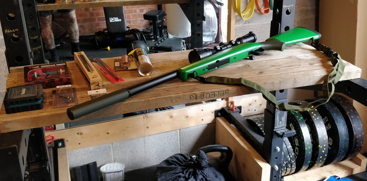

Found a great alternative use for my squat rack. My home gym now doubles as an armoury!!
Dry built the cylinder while I had 5 minutes but that's about it. Not back at work now until Wednesday night so hopefully I'll get a bit of time before then.
It's alive!!!!!
Well after firing the bloody mag release spring across the gym twice last night, I managed to find it and glue the bleeder onto its peg to stop it from escaping again today!

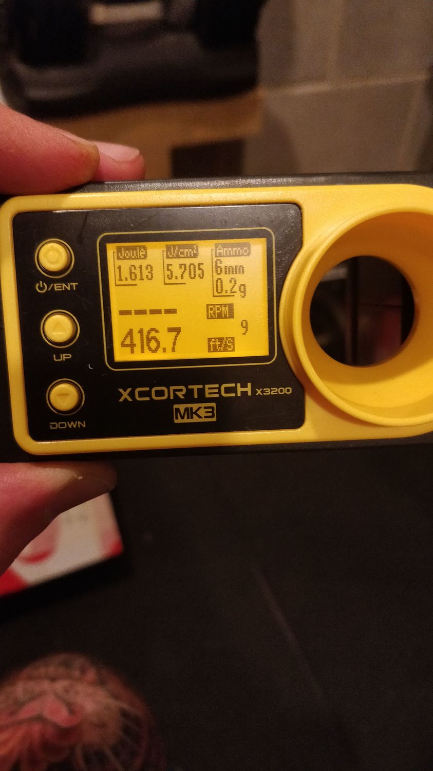

Guns built, I've been playing around with the hop until the BB stops rolling out the end. A quick chrono and a bit of paper target shooting later and I'm really chuffed!
FPS is a hell of a lot more consistent, literally changed by 1 or two FPS now!
I think the 416 FPS I got was with a bit more hop applied than needed. Will hopefully get to play about another night.
I think with a better inner barrel I might hit 450 ish, so may get the M150 spring ordered for the time being!
Fires great though, trigger is nice and light, bolt pull is a bit harder but still easy enough!

Just before you go full ham on springs, check the joules with the weight you're going to use.
I'm using some of Geoff's super precision 0.4's.
Do you think with an M150 spring and allowing enough time to break in, it'll stay below 2.3j?
Then obviously I've got the inner barrel to factor in. Would a standard 303mm or a 430mm have an affect on anything?
The 430 will net slightly more FPS but stick with the shorter barrel for accuracy, range will be identical.
It'll be easier to fit the 303 as you won't need to drill the end of the outer barrel, I've never seen barrel length negatively affect accuracy (at least anything that's decent quality or not horrifically under volumed). No qualms about my 430mm anyways and that has been hitting kneecaps at ~50m pretty consistently, ideal for me as people forget they leave them sticking out when behind cover! ?
Deffo chrono with your ammo like @Skara said - just to make sure you're not joule creeping over the limit. You can see you're already getting an extra 0.2J by using the 0.40s on what I guess is the stock barrel, obviously not a massive amount at the moment but can take you above the legal level. Worst case you can always lop some coils off the spring after you've let it bed in a little (leave it compressed overnight, etc)

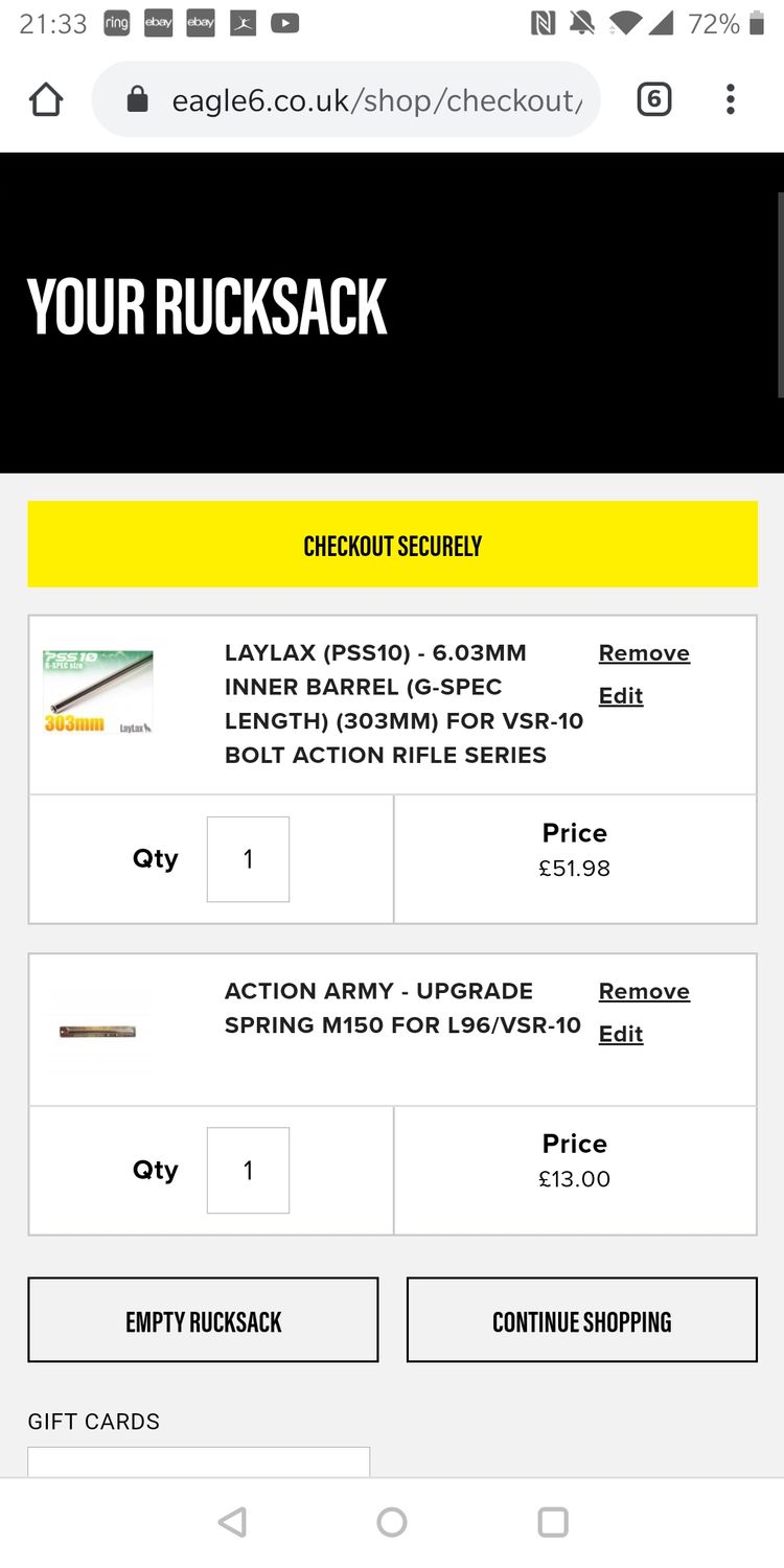

Right, so I'm going to go with the pictured.
Anyone recommend eagle6.co.uk? Basically the only place I could find with both bits I wanted.
I intend to fit the spring, chrono it, then the inner barrel and chrono again to see what or how the FPS changes!
Eagle6 is perfectly reputable if a little expensive at times. Have used them many a time. ?
Perfect @leadly
I had a the Laylax 303 before I went Laylax 430 and it was fine, even have that spring in my spares box.
Should put you right about 495 with a "normal" piston.
Looks good! Just make sure you give it a clean before you fit it to get rid of any factory/storage gunk :) Eagle6 are decent, like @Davegolf said they can be expensive some times so shop around. If they're the only ones with the barrel about though and you're hankering I know what I'd be doing?
