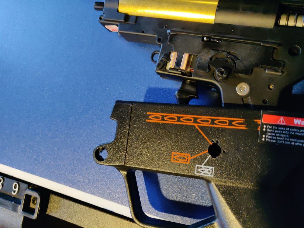

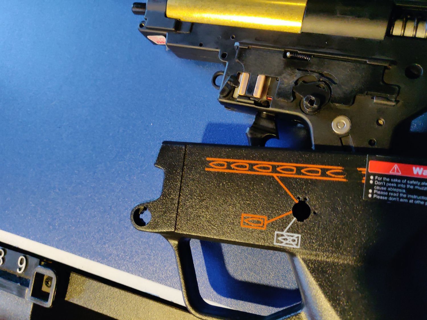

I managed to get the spring changed. Taking it apart wasn't a big job but as this was my first time opening an aeg gearbox putting it back together was though. I hadn't expected that the anti reverse and spring would all pop out in different directions repeatedly while trying to get the gearbox top shell back on. ? A 3 hand job minimum to keep all the parts in place.
Biggest headache was lining up the selector "wheel" and keeping it in place while inserting the gearbox into the lower part with the handle.

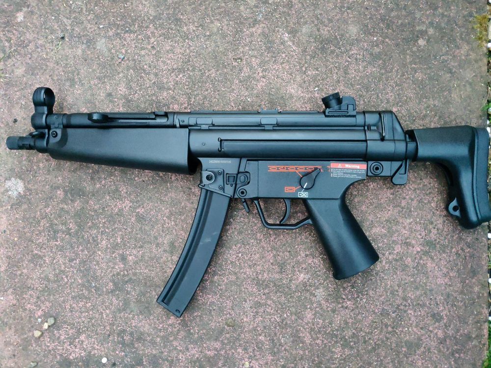

It was firing 360fps with 0.20 on the stock spring.
With the replacement spring Guarder SP90 it is firing at 330fps with 0.20 and no hop or 290fps on full hop.
Can't say I fancy doing it again and given the chance I would have been happy to pay someone experienced to do the work.
