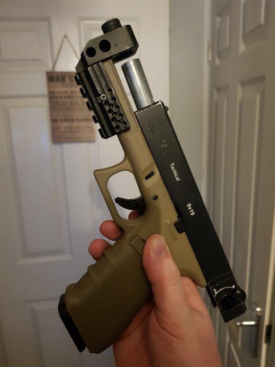

If you are not set on the CZ, you can get a thread adaptor for glock 17 and 18s that slides onto the under rail. It's called an SAS front kit.
This means that the suppressor is attached to the thread on the new extension rather than the tilting barrel, meaning no performance issues
