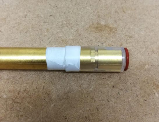

Zarrin Posted February 29, 2020 Posted February 29, 2020 And bind the rubber to the barrel with some plumbers/ptfe tape a bit like this: Helps with air loss and consistency. example is a VSR barrel but the same principal applies.
