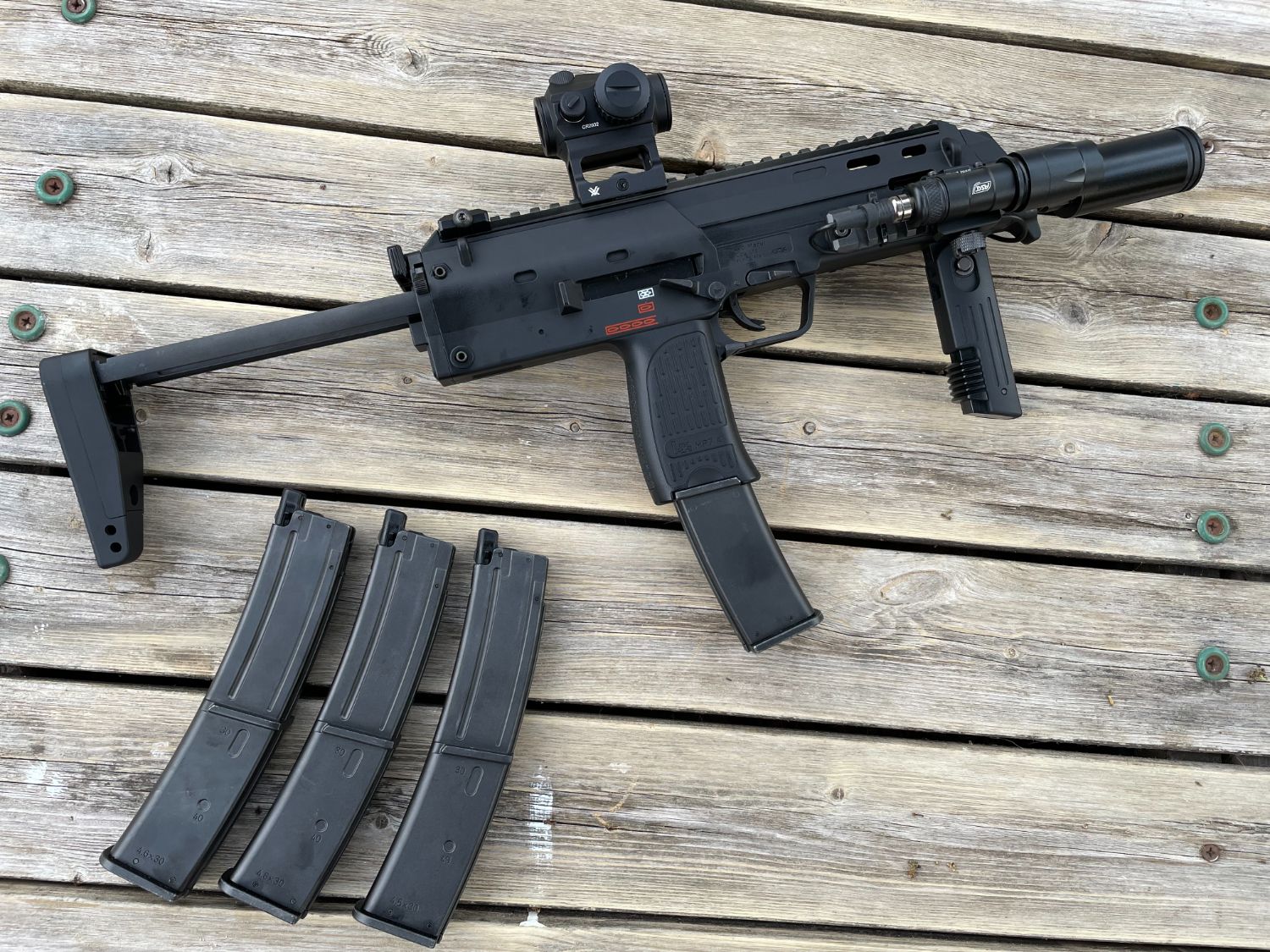

Dalno Posted June 14, 2021 Posted June 14, 2021 (edited) Here's my MP7, I've used it for a couple of games and am loving it so far. Couple of external attachments but have yet to tinker with the internals. I do worry about common issues such as nozzles and backplates cracking but have had no issue yet, so am wondering if I should get spares handy or are there worthwhile upgrades/fixes? Anyways, I carried out a few tests on the chrono and here are my results. I was surprised to see a gain of around 25fps when increasing the hop-up from off to fully on. I expected it to decrease due to the friction but I imagine it actually creates a better airseal therefore more FPS? I confirmed this with my MWS too. Also to note ASG Ultrair gave around 15fps lower compared with Nuprol 2.0 so that is handy to know if you chrono above 350 on a hot day this summer. I will be carrying out some range testing this weekend with a range of BB weights from .2g to .4g so will report back on that! Edited August 31, 2021 by Dalno formatting Shamal and Airsoftt 2

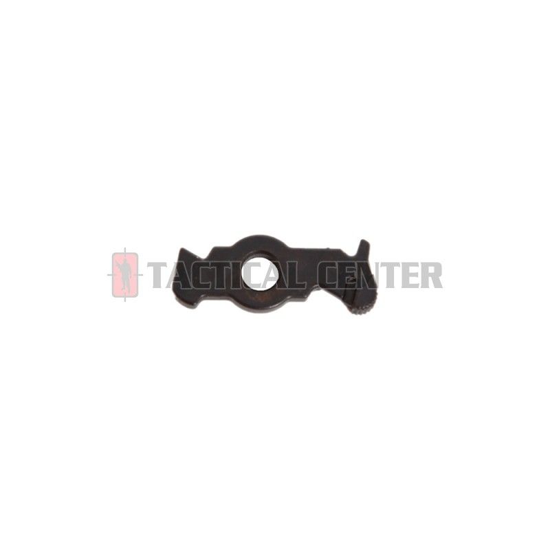

Diablo675! Posted October 15, 2023 Posted October 15, 2023 (edited) Been looking through the thread and no luck. received my 2nd TM mp7 last week, was faulty and new was trigger issue. opened it up and found out there was NO trigger bar spring, TM-MGG-81. Anyone know if there are compatible springs to fit or will I need to modify a AEG trigger spring? or has anyone HPA’d their and still have the spring going spare?? Edited October 15, 2023 by Diablo675!
Airsoftt Posted October 21, 2023 Posted October 21, 2023 (edited) A few lessons learnt from tinkering with my TM MP7: If you want to use propane and its shooting too hot, you can buy a pack of these as replacement rocket valve springs to cut them down to size to get the fps you are looking for: https://www.amazon.co.uk/dp/B076M27VH2 much cheaper and easier to source than buying individual originals from TM. Changing from stock to a Laylax purple hop rubber and 6.03 barrel somehow lowered my fps when the hop was set for .25s. I assume this is because the hop rubber is softer. With a T2 + unity high mount clone you can get a decent cheek-weld and sight picture even with a full mask like a empire EVS. I found overfilling the mags with bbs causes the the mag to put pressure on the nozzle and not feed the first round - this could just be a tolerance with my gun though. Changing the barrel sucked, I kept knocking the trigger bar out and I wish to never do it again. I was going to put a silicon ML hop rubber in my MP7 but after seeing so many bad reports I left it out and went with the Laylax purple one instead. Also red dot recommendations: Vortex Crossfire is good and you can get custom protectors for it on ebay from red_dot_engineering Edited October 21, 2023 by Airsoftt recommendations Mr Dellski 1
Airsoftt Posted November 3, 2023 Posted November 3, 2023 On 16/10/2023 at 00:43, Diablo675! said: Been looking through the thread and no luck. received my 2nd TM mp7 last week, was faulty and new was trigger issue. opened it up and found out there was NO trigger bar spring, TM-MGG-81. Anyone know if there are compatible springs to fit or will I need to modify a AEG trigger spring? or has anyone HPA’d their and still have the spring going spare?? @Diablo675! Found a spring for you man: https://www.replicantairsoft.com/webshop/en/inicios/2065-mp7a1-fire-selector-bar-spring-mgg1-81-tokyo-marui.html In other news I ordered a Revanchist Gold Power Nozzle Valve for a VFC MP5 and because rumour has it they fit and could be interesting for running propane in summer (could be a terrible idea). And my FPS woes are now solved. I'd done the screw too tight on the hop up when doing a barrel change, leading to a 40fps jump! Am now comfortably able to use propane in winter.
