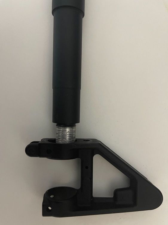

On my mtw the outer barrel is 1-2mm too thick for the front post I have, so need to sand/enlarge inside of the front post to get it to fit. Not sure if the MTW outers are built to a different spec
Pic: The post clears the first inch of the mtw barrel but then it widens slightly.
