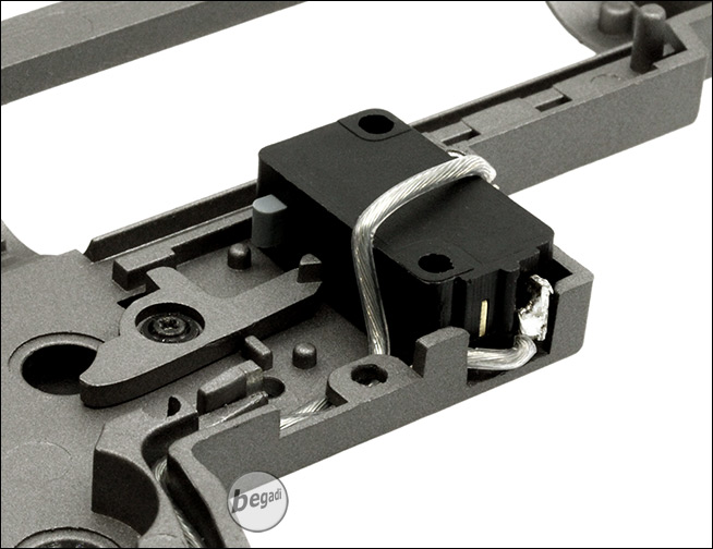

Supporters Sitting Duck Posted September 8, 2018 Supporters Posted September 8, 2018 40 minutes ago, Animalben said: So things in my head to do or attempt are the following 13:1 gear set New Hop up (thinking rotary) New trigger (I like the look and feel of a flat one)# I am also not opposed to trying a new micro switch if you guys think a "better" one will stop it breaking but I was told this wasn't possible by the tech. That's probably a lot of waffling and not very coherent, apologies 13:1 gear set - will work New Hop up (thinking rotary) - hmm if so just buy a cheapo shs/element plastic one (pro-win cost money and "can" be picky in some guns New trigger (I like the look and feel of a flat one) - DOUBT IT The trigger is bespoke in these micro switch boxes actually the whole f*cking trigger/Cut Off Lever is bespoke but micro switch is not that bespoke - just a case of finding the industry std switch w@nky trigger system... https://www.begadi.com/begadi-hw4-abzug-komplett.html bespoke COL... https://www.begadi.com/begadi-hw4-cut-off-lever.html you see it better in the gearbox/switch pic all in all a bespoke wanky gearbox tbh (email protected ??? w@nky or w @ nky - ok use wanky instead) good idea with quick change spring but the micro switch system is prone to failing be it the switch, the trigger (not so common), plus long term the odd qwirky bespoke COL If ever there was a gun that should have had a mosfet fitted as standard to stop the micro-switch burning out yup it was the Nuprol - Action Army - HW quick change gearboxes as I said I wouldn't go ultra nutz on it I'd be tempted to consider a £60 replacement gearbox or rebuild one maybe - or maybe just forget sinking money into it But tbh I'd try really hard not to sink too much time & money into it just keep it ticking over and keep as spare/back up gun as is save the money for a better gun or tweaking something more worthwhile The gun looked a good idea on paper but the gearbox is a bit bespoke and can mess up then you find out some bits are not so easy to swap out around trigger-switch-COL etc....

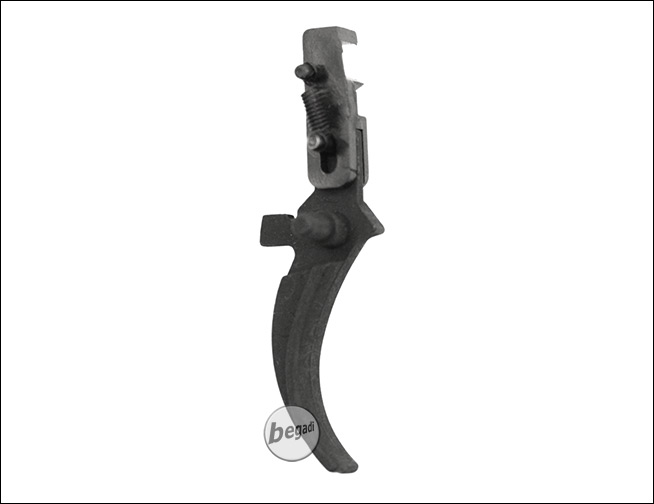

Iceni Posted September 9, 2018 Posted September 9, 2018 36 minutes ago, Sitting Duck said: Good shout sir - about op's best option than get ripped off by techs/redoing the Nuprol box Reworking a nuprol is like opening pandoras box. You replace the contacts, the COL, the trigger, Add in a v2 saftey lever, Replace the selector plate, then realise you need a new gearset to kick the COL correctly. It would be easy to spend £45 and have nothing to show for it, other than time wasted. How nuprol get away with a microswitch without a fet is criminal. It's engineered to fail, An arcing microswitch is a dead microswitch. Even in perfect running conditions the added resistance and heat build up on them embrittles the mechanism and causes premature death.
Supporters Sitting Duck Posted September 9, 2018 Supporters Posted September 9, 2018 indeed - even though places like Begadi stock the crappy bespoke bits n bobs it just ain't worth it - same as HW helmet World (snigger), Action Army or whoever them boxes are asking for grief long term and sourcing bespoke parts or agro converting The EC/Specna box is what should have been used - tried n tested box but with QD spring even the switch on EC is like the G&G or SHS non-prong/contact copper plate selector everything looks sound - bar an o-ring nozzle like you said not sure if bearing spring guide but no mega disaster not re-enforced at rear so high speed gears can go straight in like G&G boxes Even stock gears look similar to JG stock gears though can't see the underside of bevel but I personally give JG gears the edge over many other stock cheapo gears so the stock gears "look" sound too It is still a quick change box so easier for novice to work on getting their feet wet For £45 in UK that is damn good quick replacement box considering a stripped piston will cost you say £7~£8 for a SHS full rack piston alone if ya box wrecks to bits inside or shell cracks - there's ya answer & swap spring over
