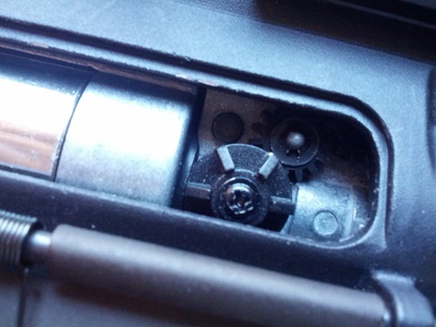

THIS.....
Related image
if the hop doesn't sit right up against the gearbox then air will leak
when a mag is inserted the mag might try to pull the hop away from box slightly
sometimes there is a spring on hop unit to push it back to keep the seal or o-rings to ensure hop remains sealed....
