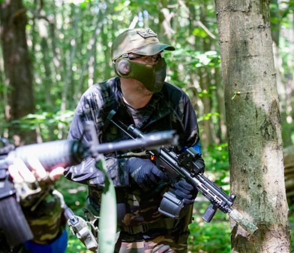

Popular Post PopRocket123 Posted August 30 Popular Post Posted August 30 My dad was working on a HK21 PDW build a while back. He was using a TM with the aftermarket metal receiver as a base. He got as far as designing the barrel shroud and feed tray and doing a test print before it was resigned to the pile of abandoned projects MSSNAFU, Baser, Cocha and 2 others 5
Lyndication Posted August 30 Posted August 30 HK21 PDW is a hilarious concept, that's some great CAD work there though. MSSNAFU 1
PopRocket123 Posted August 30 Posted August 30 1 hour ago, Lyndication said: HK21 PDW is a hilarious concept, that's some great CAD work there though. It's utter insanity but apparently there is at least one real one out there that exists. You wouldn't can't me firing it though Lyndication, Lozart, ButcherBill and 1 other 2 2
Cocha Posted August 30 Author Posted August 30 4 hours ago, PopRocket123 said: My dad was working on a HK21 PDW build [...] This is AMAZING!!! He should resume this project, it is SO promising. MSSNAFU, PopRocket123 and HZR13 3
PopRocket123 Posted August 30 Posted August 30 1 hour ago, Cocha said: This is AMAZING!!! He should resume this project, it is SO promising. He should but trying to get him to finish a project is like pulling teeth. Maybe I'll inherit it since he doesnt play anymore and actually finish it one of these days lol HZR13 1

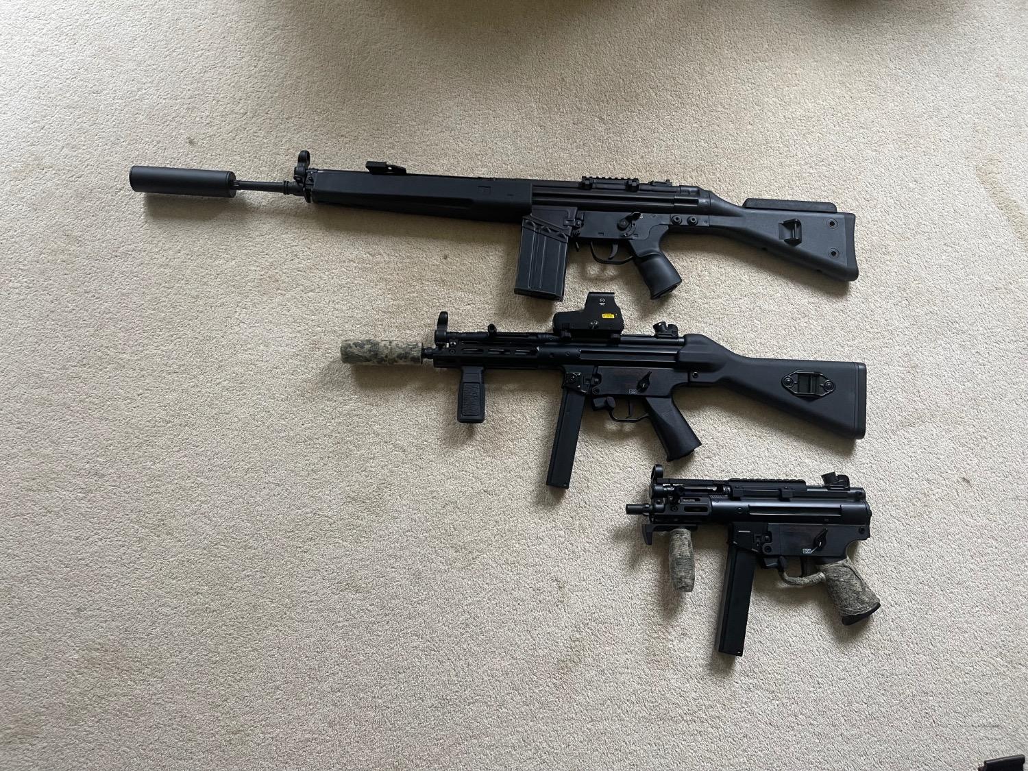

Baser Posted August 31 Posted August 31 That looks epic, closest I’ve got is a drum mag in my MP5 which just pales in comparison. HZR13 and ButcherBill 2
