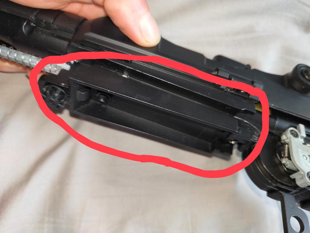

I'm looking for a replacement for the inner magwell as the feed tube is broken but I can't seem to find what I'm looking for, does anyone know what it's called or the part number?

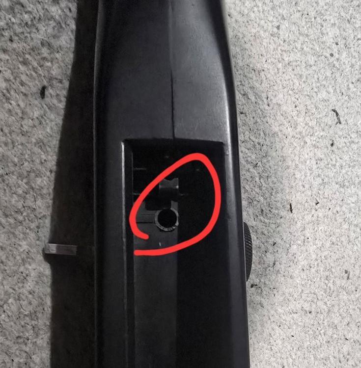

No it's not the bottom of the hop unit unfortunately (would be easier to find parts) this whole section circled in red is what I need.

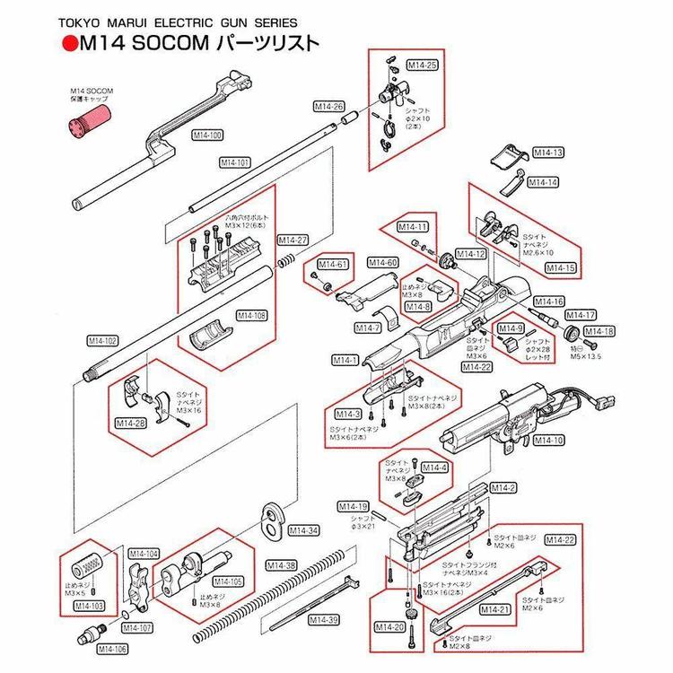

Hmm - the below is the parts diagram for the equivalent TM model (which I presume the Cyma is largely/entirely based upon). It's rather difficult to fathom out - is it part M14-2 ? But - I’ve just had a look at my (assembled) CM032 - that whole part you circle is made of metal. From your original photo, it looks like the part that has snapped is plastic? If so, it is simply the feed tube that is part of the hop unit passing through a hole in that plate. It's a while since I had mine apart so i can't say for certain, but if you are able to ascertain the snapped part on yours is plastic, that’s a good clue that it is the hop unit that needs replacing only.
I think you're right, it is M14-2, you can see where the little hop adjuster passes through the front.
But i agree it looks like the hop's broken. If the snapped part was metal it's by silver where broken, and it looks like there's a clean break seperate from the 2 horizontal ribs either side.
