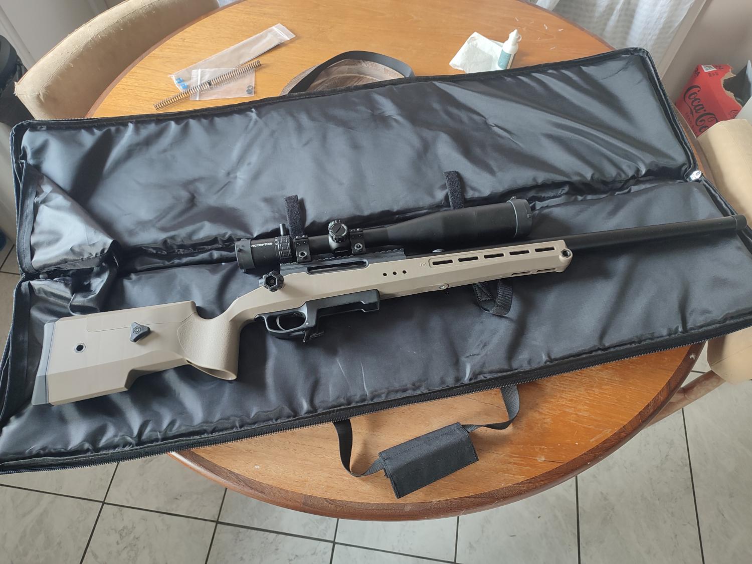

Fatboy40 Posted December 27, 2024 Author Posted December 27, 2024 I've bitten the bullet and bought a TAC-41 P (in FDE) from Skirmshop, let's see how long it takes to arrive over Christmas. In the end I decided... I didn't want to buy second hand, I'm just not sure I'll trust what I'm getting. I thought it best to go with the longer inner barrel and the solid body (a bit more old school). So I've now got until 2nd Feb 2025 to get it just right, ready for the next Red Alert "Battlesim Lite". I think I'm going to go 0.48g and the 120n Silverback spring, but not sure which scope ? (probably a LPVO, 50mm, and use it at around 10x)

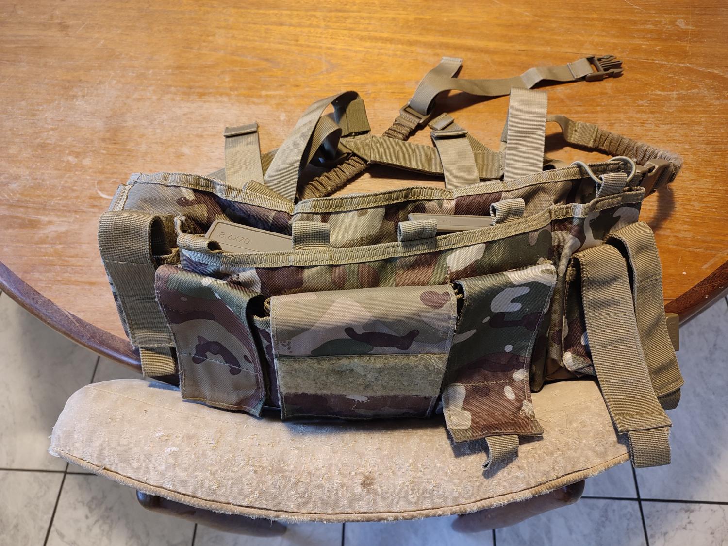

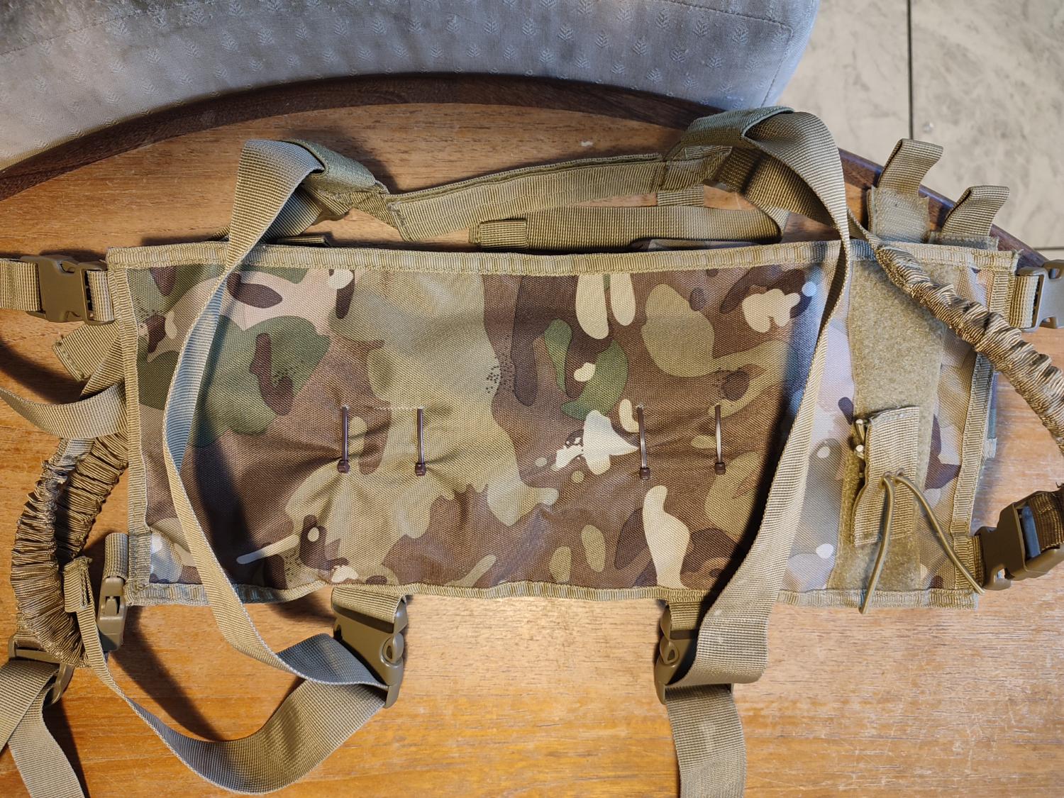

Fatboy40 Posted January 27 Author Posted January 27 I'm all ready to rock now, getting around 2.22J on 0.48g. Itching to use it in anger but now the weather this weekend looks poop for the Battlesim Lite at Red Alert I also had my son's old Viper ready rig, he just runs a belt now, now fitted with a couple of Kydex Customs TAC-41 extended mag holders. Rogerborg and ButcherBill 2
