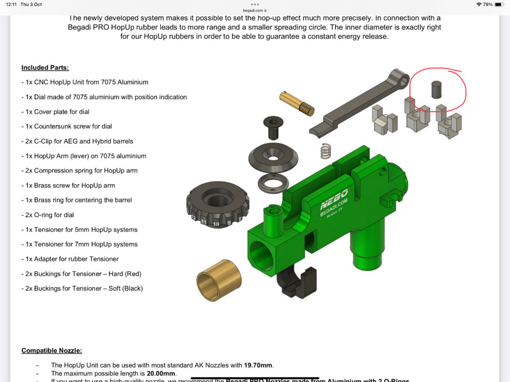

With my hop fully off (Onto 0), there’s still a small section of the bucking showing. Is this normal, or have I done something wrong? It all adjusts fine.

You need to slightly trim the rubber cylinder.. don't overdo it ;) it's less than half a millimetre :D
(don't ask how I know)
Sure, the observable reality is that you're getting more hop than you need and so will have to remove some material if that's really the lowest hop setting.

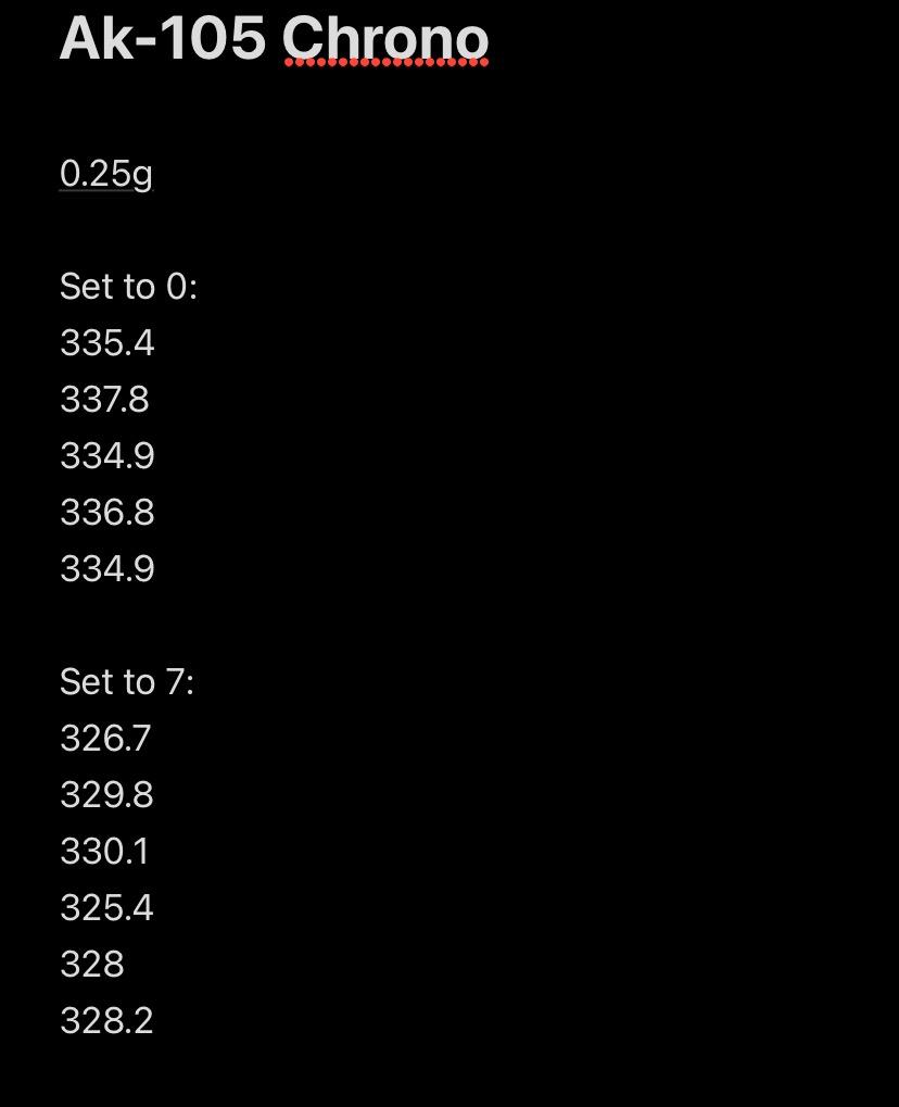

0.25g BB’s

The spring wasn’t under the tensioner originally, so it now is fitted. This time the hop off has no bucking showing, turning to 14 (max) has about 1/4 of the barrel “blocked” so seems fine now. Going to Chrono in a moment and make sure stability is good ??

The Begadi hop units tend to over hop with even a small amount of adjustment unless you trim the rubber cylinder.  I run a couple with Macarons and Omega nubs; they barely need moving off zero to get perfect flight.

Are you using the red or black rubber cylinder that fits in the top of the metal nub?  If you are, trim a tiny amount (about 0.5mm) off the end of that and try it again.
If you are using the left hand one of the three metal "nubs`" shown with a normal or Omega nub, you may need to do some careful filing of the top part where the arm sits on it.
48 minutes ago, JinxDuh said:
why am I trimming the bucking?
nobody said anything about the hop up rubber.........
Tried the left hand one, sanded down the top and now with the hop set to 0 it shows a tiny little bit but it’s much better than it was. It looks like the nub is slightly pushing down on the left side more than the right but it might just be my dodgy eyesight ? Will test it at a range this Sunday and report back!

Chronoing exactly the same as above (with the hop on 0), 52 shots and only one “miss fire” aka not firing
With the hop set to 7 (half way) I got 7 non firers within 29 shots. So I’m assuming the hop rubber is the cause
With the maple leaf inner barrel and black bucking, out of 85 odd shots, it didn’t not fire once (Hop set to 0), hop set to 7 with roughly 50 shots it didn’t fire twice. Very confused ?
