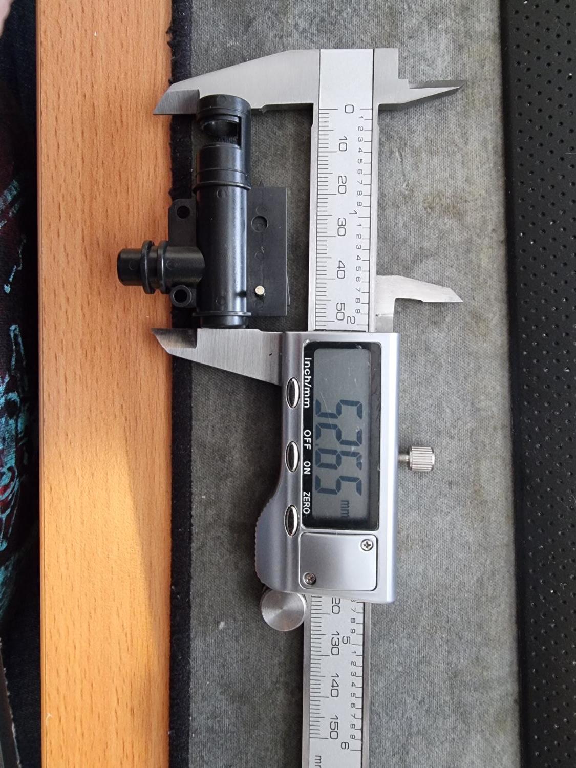

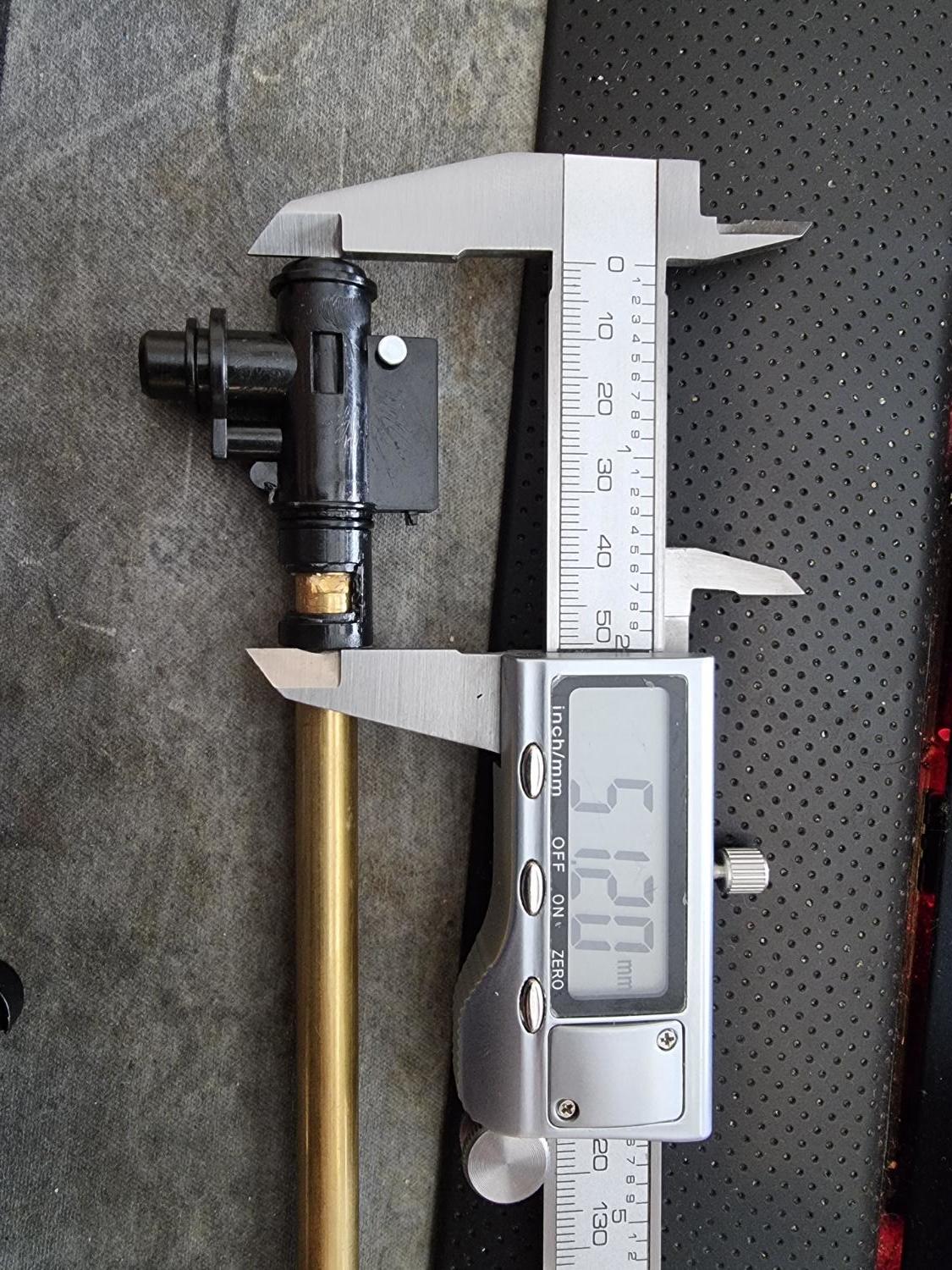

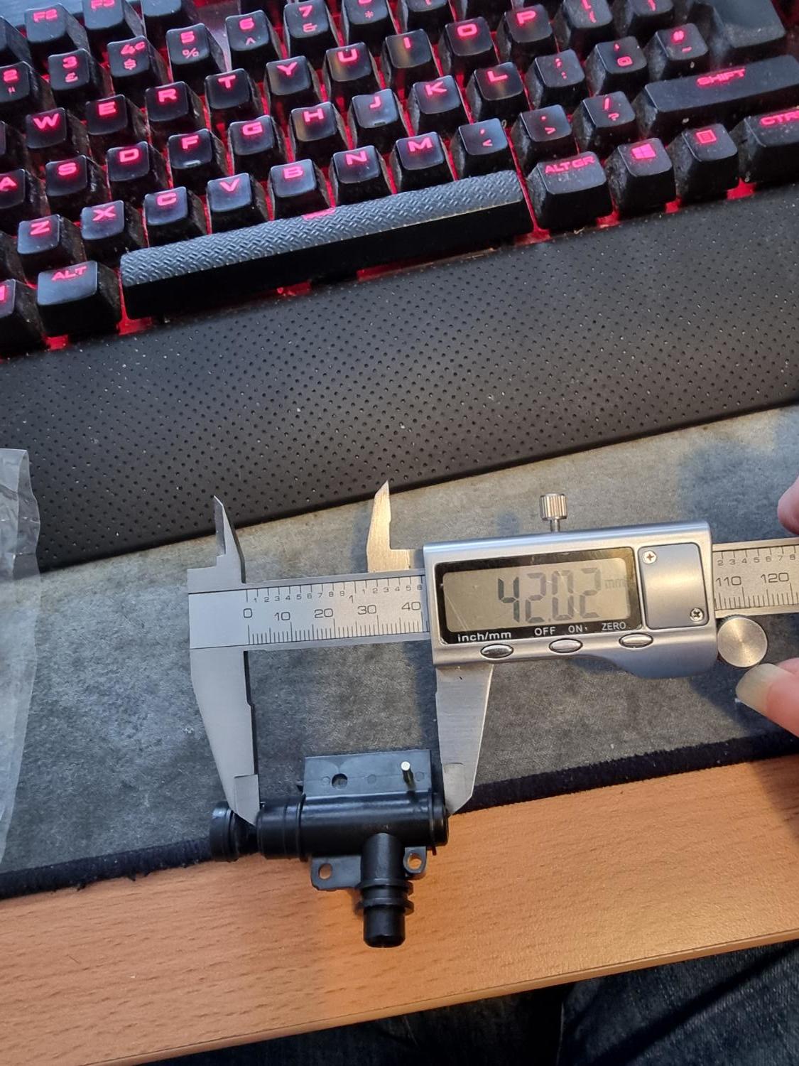

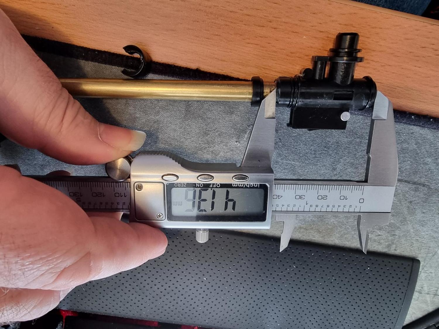

Hudson Posted September 4 Author Share Posted September 4 If it makes sense without being able to actually show you, then the entire length of the unit, minus the hop wheel, and the measurement from the rear of the hop unit to the rear end of the space for the barrel clip would be good, please! Thanks Lozart 1 Link to comment Share on other sites More sharing options...
Supporters Lozart Posted September 4 Supporters Share Posted September 4 38 minutes ago, Hudson said: If it makes sense without being able to actually show you, then the entire length of the unit, minus the hop wheel, and the measurement from the rear of the hop unit to the rear end of the space for the barrel clip would be good, please! Thanks Also - from the front end to the internal ridge that secures the feed lips is 33.7mm Hudson 1 Link to comment Share on other sites More sharing options...
Hudson Posted September 4 Author Share Posted September 4 Thanks, I've got a spare JG one at home, so I'll compare the dimensions with that and see if there's any difference. 🙂 Lozart 1 Link to comment Share on other sites More sharing options...
Supporters Lozart Posted September 4 Supporters Share Posted September 4 1 hour ago, Hudson said: Thanks, I've got a spare JG one at home, so I'll compare the dimensions with that and see if there's any difference. 🙂 Here's the one from mine: Hudson 1 Link to comment Share on other sites More sharing options...
