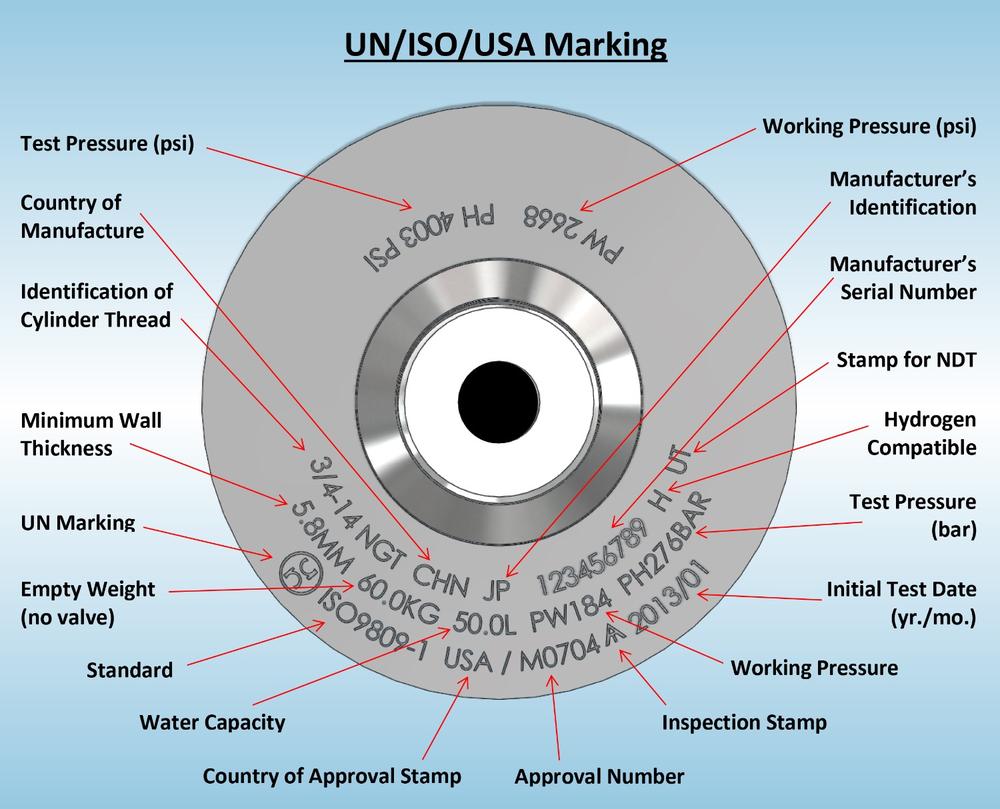

Is it really a 310bar tank?  That’s 4500psi
Are you reading the markings that include many details and you have read the failure pressure?
A 13ci aluminum cylinder designed for 3000psi use is exempt from hydro testing and can be used forever whilst it is physically sound
Look it over, if it is fine then for your first question it is OK to use

The writing on the tank says
0.625X18UNF TW DCEC AA6061 T6 PW205PH310BAR
(Pi)0035 -40C D 2009/11 A000122
Burst disks have 4.5K and 8K stamped on them.
2 hours ago, 38super said:
PW205PH310BAR
PW is the working pressure
PH is the hydro testing pressure
A working pressure of 205 bar is designed for 3000psi
