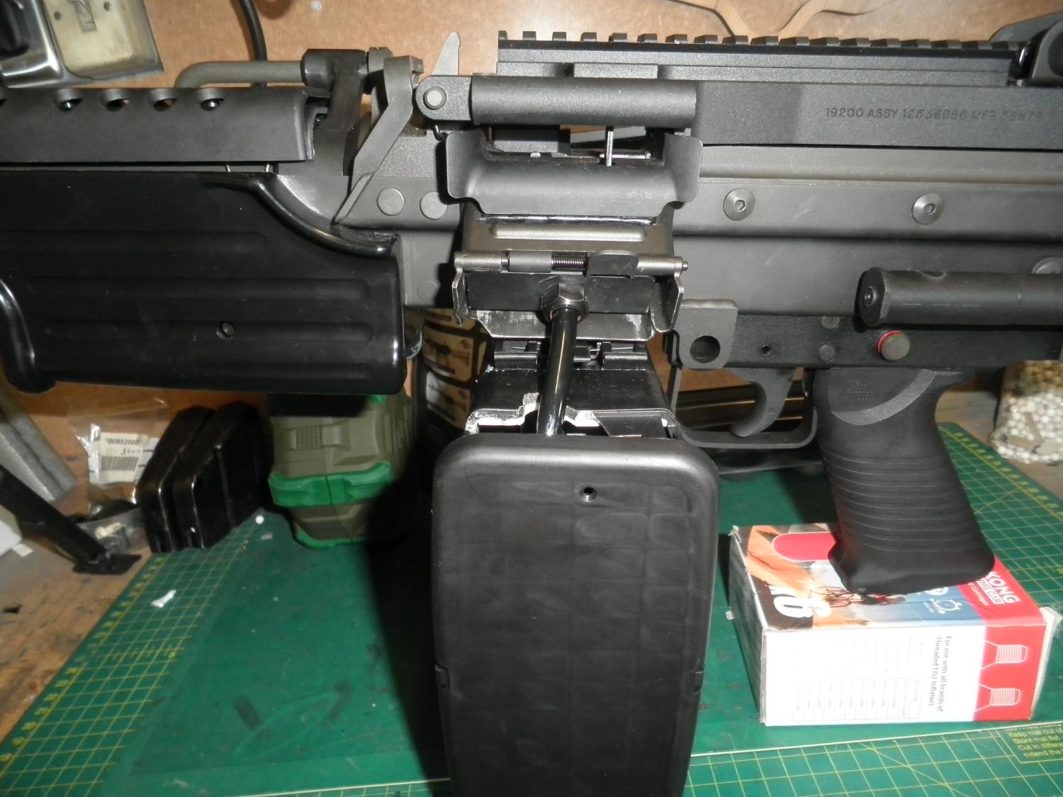

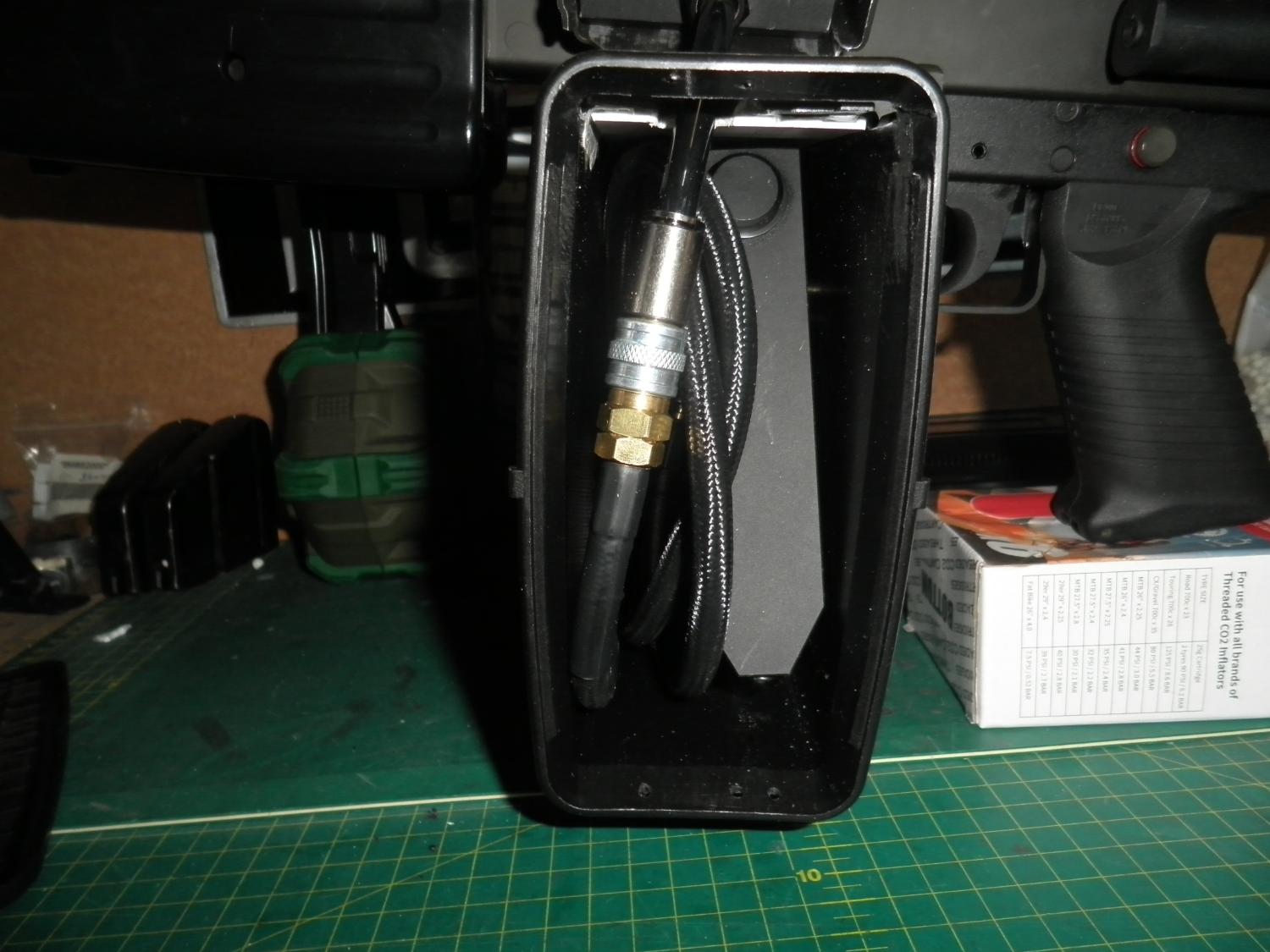

Had a try of the adapters. Using a couple of 16g CO2 capsules at the moment . Everything fits easily in the box mag and the 249 cycles happily.  It will also fit in the 200 round R/S fabric mag.
For now I've used a section of pipe from the hpa kit I got for it when the kit first came out ( was interested in different ideas for connecting the box mag) and the oush fit end from the same kit to replace the split original feed and connected that to the CO2 block with an hpa line .
I'l take a picture tomorrow. But it allows quick and easy connection .
Obviously the 'normal' conecter will work fine, but mine also failed so made this up.

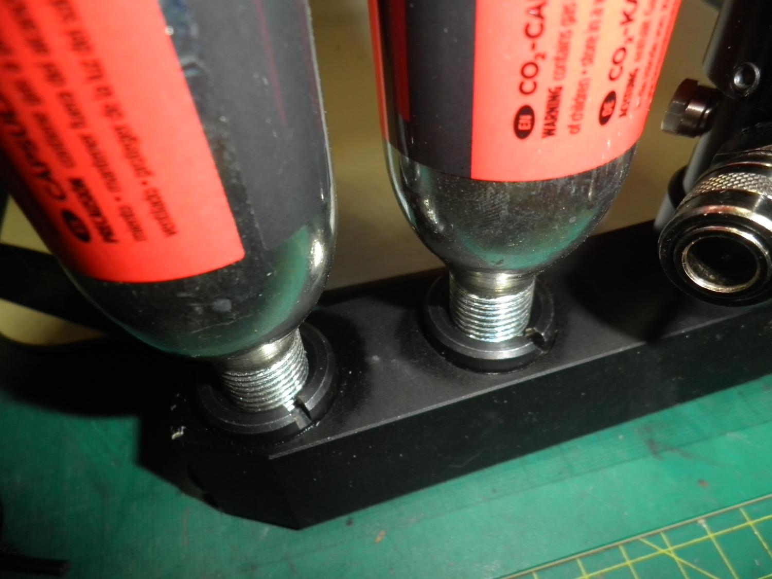

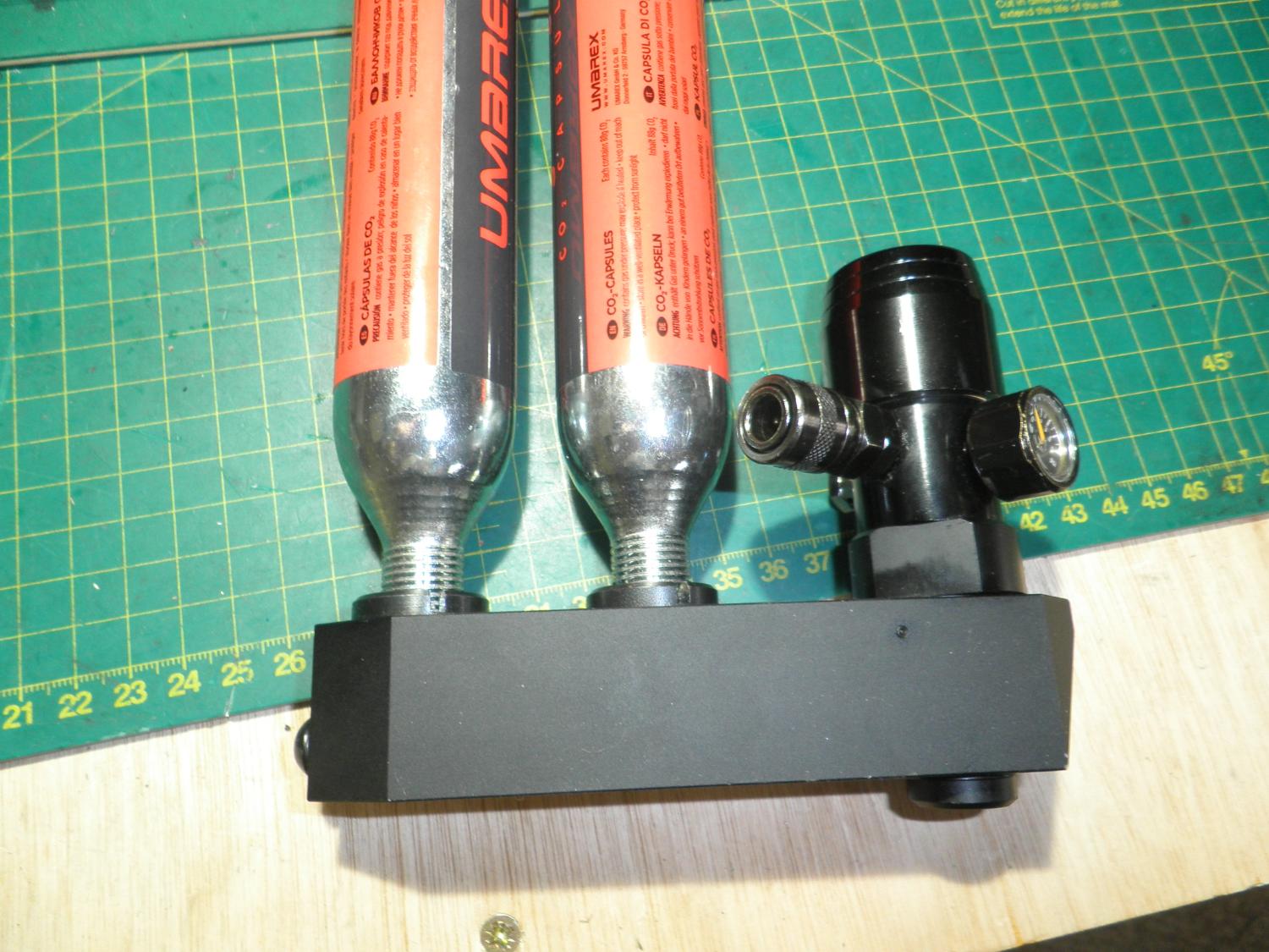

If anyone can post some detailed pics of the block the capsules screw into i can tell you if it's something i can make with different threads to suit different capsules.
I can get some pics . The block has an integral regulator though . What would be good would be insetrs that screw in to the existing threads . I do have a couple of adaptors that screw in and allow smaller capsules to fit .

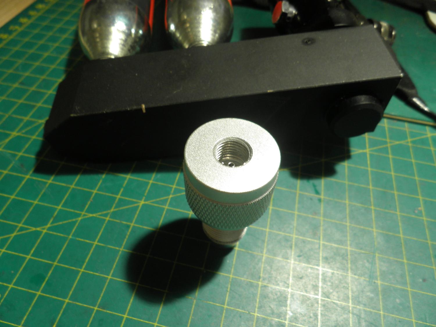

And the adapters I have . Something like these to use something smaller than the 88g would be good.
I have the same adapters,  but I have been unable to find a thread tap that can cut a  thread while also working around the puncture pin, as I don't see any way to remove it.
I would very much like to find a way to cut a 1/2"UNF thread so I can use 66g cartridges. I have a contact that can supply "expired" cartridges from overhauled lifejackets
I'll have a look into it. The block itself is probably pretty basic and the regulator will come out. Looks like there's a channel drilled inside that's blocked off with a plug on the left.
Adapters are probably fairly simple too.

The pin's probably pressed or bonded in. Making adapters for ½" UNF is probably as easy as any other.
I wonder if the bosses that the capsules screw into are themselves screwed in . They do have a slot on top. Next time I dont have a 'live' co2 capsule in I'll have a look at that .
If they are , then replacements with the smaller internal bore might be an option .
I think that is the case, but they may well be fitted in with sealant too.
