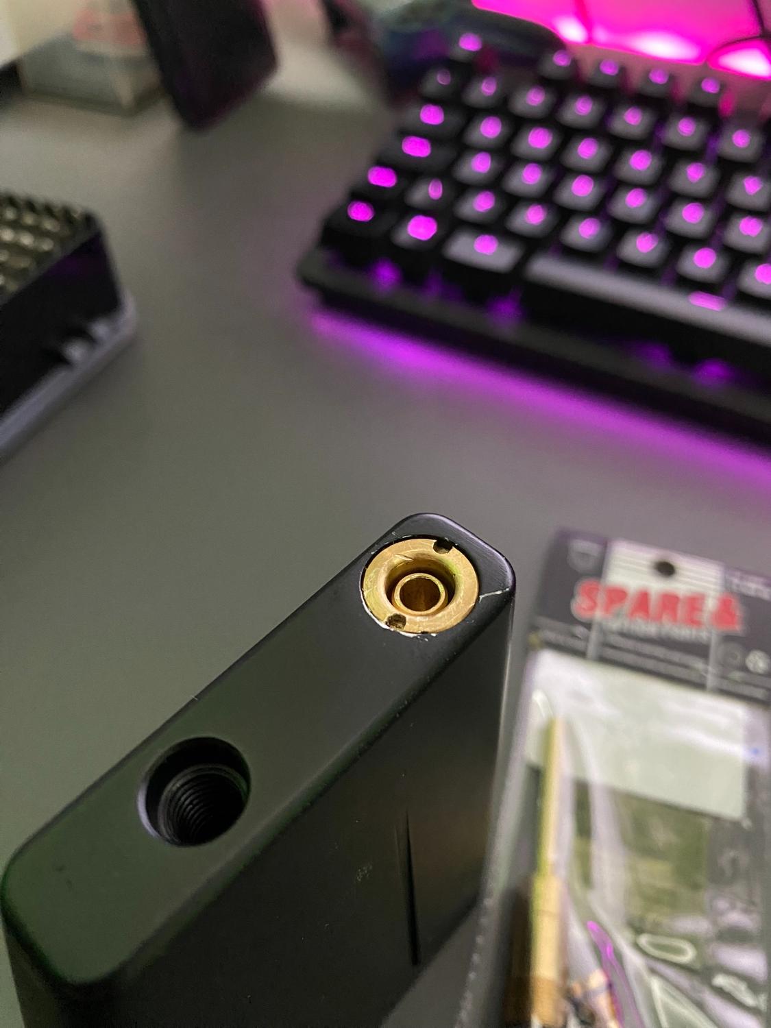

This is a complete shot in the dark but after tearing my hair out and searching everywhere I just can't find an answer - what kind of valve key do you need to take this bloody thing out??
Every thread, forum or video I've seen simply says "just use a flathead" (which is impossible as the GE 870 doesn't have slots like the TM 870 which is what every video/post is about) and despite having the parts to repair this thing for literal months at this point I've just been stuck unable to get this bloody valve out.

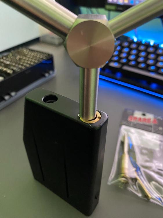

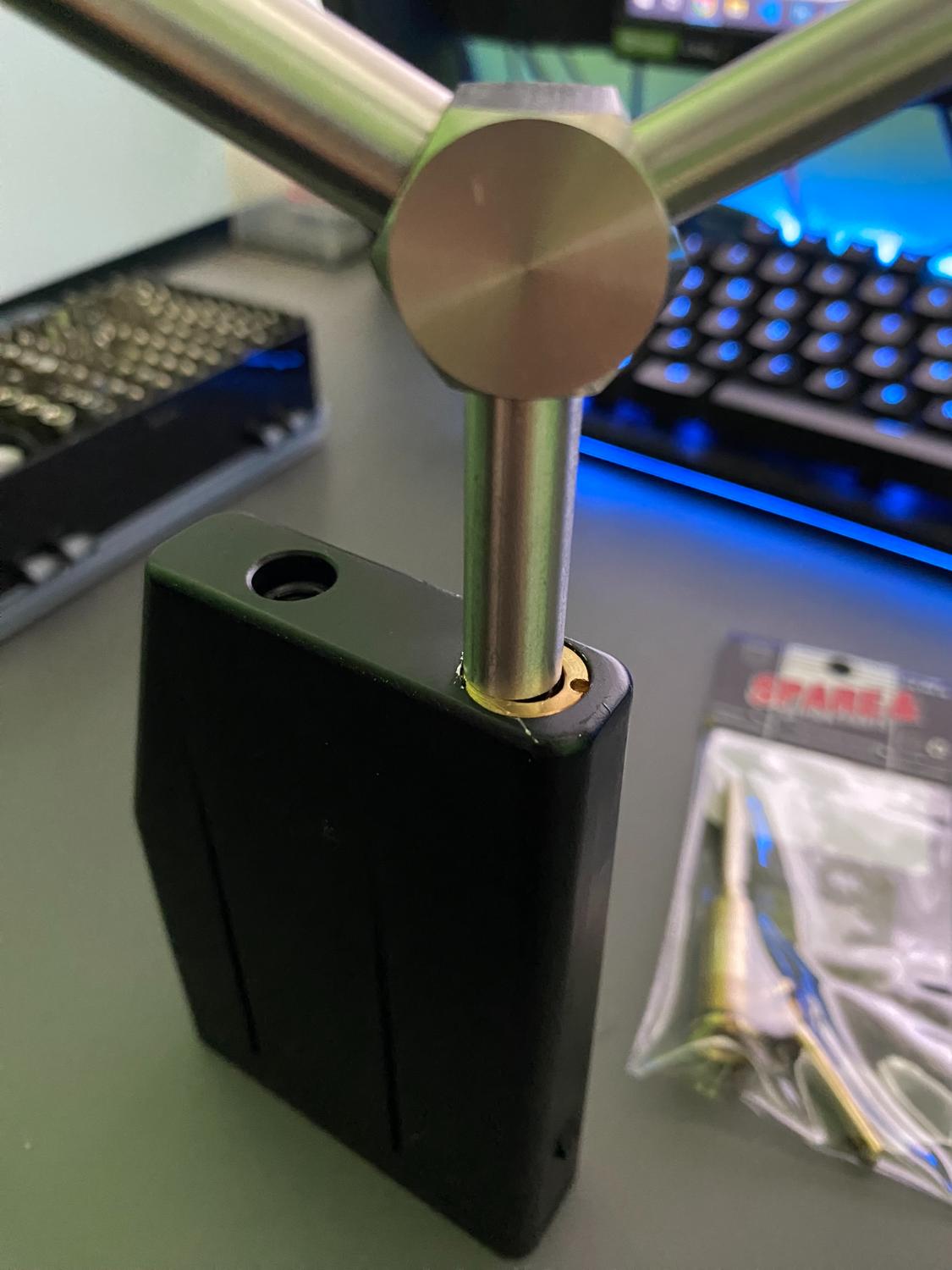

I tried ordering a valve tool in the vague hopes of it working (pictured below) and while one of the styles is correct it doesn't fit and therefore the valve is still stuck. As it will be forever, apparently.
Anybody got any ideas? It's driving me nuts, espcially when the only results that come up with regards to the GE 870 on google are just pages to buy the fucking thing and nothing else.

Yeah, looks the same as the valve key I nabbed and that was in the photo. No dice on mine, unfortunately
Was half thinking of just cutting a tiny slit in both sides so you can fit a flathead in like a TM tank, and considering the TM tanks work fine in the GE 870 I can't see it having any issues.
