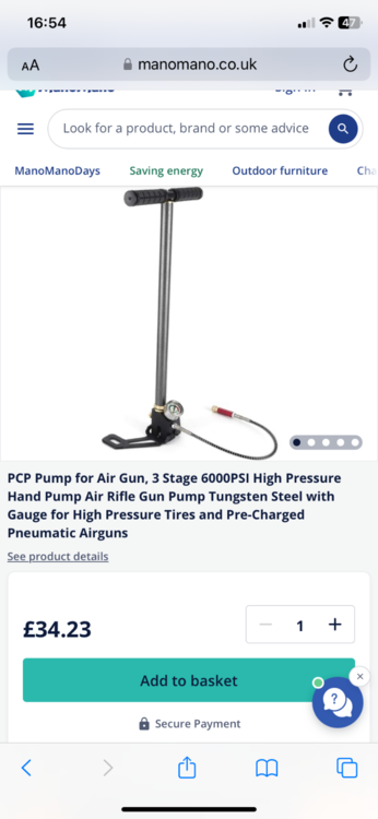

Does anyone know if this pump is suitable for HPA?
looks to be about half the price of any I can find on Airsoft websites
You mean to pump up your gas bottles? Decent quality ones are around the £80-100, so you pay your money and you sweat your b******s off doing it.
Yeah to pump gas bottles.

No, buy an air tank. Pumps are a mugs game, no matter how good they are
It’s necessary to have serious doubts about cheapness of high pressure items and their reliability
Let alone why that one claims to go to 6000psi but is cheaper than the 4500psi model, and that it’s short ‘product details’ give different specifications
https://www.manomano.co.uk/catalogue/p/3-stage-pcp-4500psi-air-rifle-hand-pump-with-pressure-gauge-58884898#tab-description
https://www.manomano.co.uk/catalogue/p/pcp-pump-for-air-gun-3-stage-6000psi-high-pressure-hand-pump-air-rifle-gun-pump-tungsten-steel-with-gauge-for-high-pressure-tires-and-pre-charged-pneumatic-airguns-53871693#tab-description
If they were to be believed then they need inline filters added.
