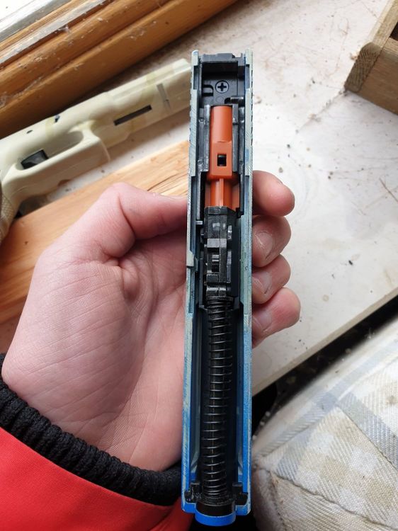

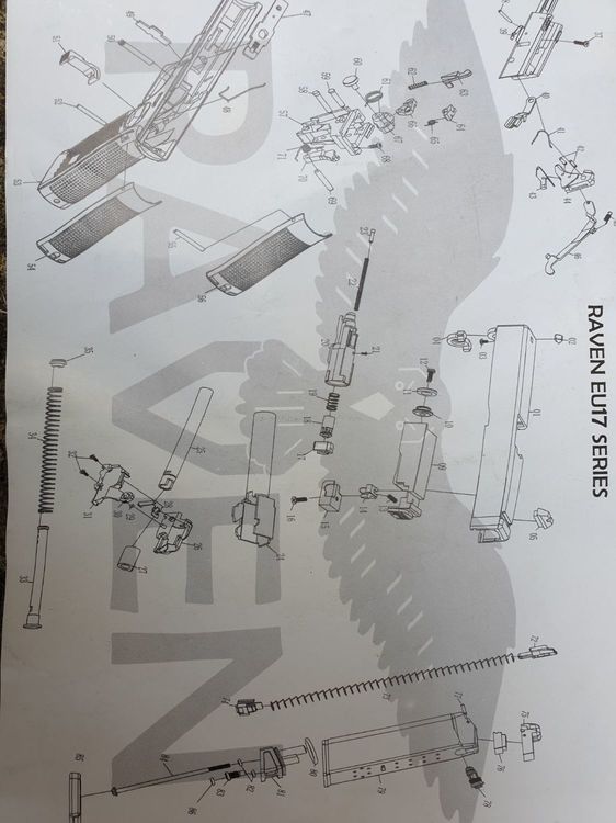

I am new to airsoft and have bought a Raven just for some back yard plinking. However the trigger assembly no longer works. I think the video shows the problem far better than I could possibly explain in my own words. If I rack the slide and pull the trigger nothing happens , no gas is released( with a mag) and also I don't hear a click or feel the trigger pressure relive itself. I have a list of parts Which are attached below. Is there any chance that I could fix it myself or is this advanced and needs to be sent back to a shop. If I can fix it myself Does anyone have good tips and tricks on how to.

How old is it ? if you've  only just got it then I'd send it back.  Certainly on my G18 the trigger doesn't release the hammerif the slide is off. As I recal the last Raven 17 I had on the bench had the same issue of the hammer getting stuck down.  If you decide to replace the hammer unit , the WE one fits the Raven , however the last Raven 17 I had apart needed a WE G18 hammer unit.

Probably not, it looks as though something isn't engaging inside the trigger unit.  At this point you might as well try and extract it, although be prepared to catch a lot of small pieces that will make a break for freedom.
