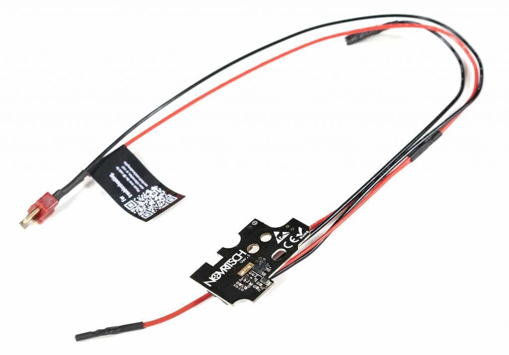

It's not a Gate, not sure if it's optical or not. It's the one pictured below.

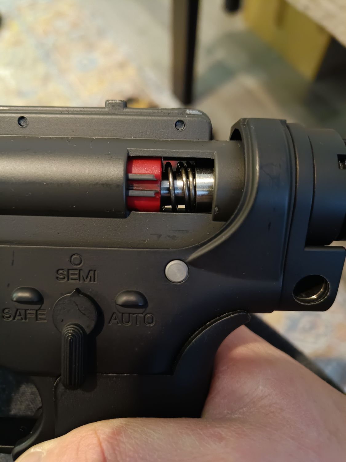

I was just messing around with the pre-cocking settings. I couldn't see the difference until 4 out of 5, at which point the piston came back as far as pictured...which I'm not sure is too far or normal for pre-cocking?

hmm, it doesn't look like it's running and obvious levers that interact with a col (like the old school ascu's), and "cycle detection" generally inferrs something watching the sector teeth rather than relying on the cam.
it really depends on the specific build and your preference.
to me your picture is what i'd call "adequate", but then my hpa days kinda made me a tad obsessive about minimal lock time.
mechanically, there's not really an issue with any level of precocking as long as you de-stress the spring before putting it in storage (afaik perun mosfets have a function for doing this), you'd want a build worth its salt to be able to start from any point in the cycle.
electrically, the more precocking, the more load on the motor on startup, the more current it'll draw and if the mosfet doesn't like it then it'll either cutout (if it has overcurrent protection) or in the extreme go pop.
i'm wondering about those compression rings, do they clear the piston ok? it might be worth looking at running a stronger spring without the rings to see if that helps, might be if the piston clips the rings it locks up (once had a box do that on the spring, when the spring was compressed it expanded just enough to bind up inside the piston and lock it to the rear)
Even on 4/5 for pre-cocking (which is higher than I've ever run it), it didn't look like the compression ring and piston met.

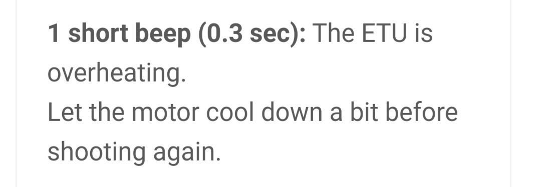

I'm wondering about the battery side of things now. It was omitting one short beep every time....

it's more how far the piston retracts during the shot before it slips off the sector gear, which isn't affected by precocking.
that's definately pointing towards it being an over-currrent or similar system, lowering the precocking might help it enough, as will a weaker spring (if you're happy to take the energy drop that'd give).

From what I've been told the fet the ss4 uses is the same / very similar to the ChiLuns, it could be that the one of the micro-switches is failing.  Had it happen to one of the test ones.  Maybe email and Nov support and they might put you in touch with the guy who does the UK support.
From this photo it looks like micro-switches...
https://eu.novritsch.com/wp-content/uploads/2022/06/ETU_SSR4-600x600.jpg
... and for a rifle that costs around £270 (with the metal receiver) I'd maybe be expecting something a bit better? (in the context of what you get with a Double Eagle M900 or a Specna Arms with a GATE Aster).
As an update:
I'm now convinced it's a case of overheating rather than lock-up.
I tried the gun again on Sunday, in a much slower pace game (ie fewer direct "targets"). However the same thing started happening before I'd even gotten through 150 rounds. I contacted Novritsch customer support and after a few days they replied that it's likely one of two things:
