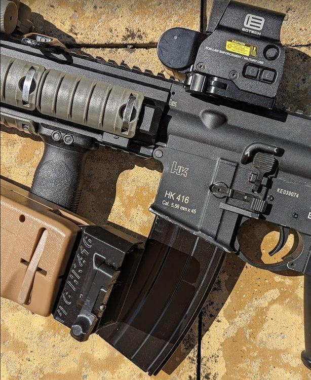

The VFC Odin adapter has arrived!
Decent bit of 3D printing... but does it work?   Yes!
Here are my initial impressions...
Caveat 1 : My Odin is one of the cheapo knock-off versions that I bought for peanuts from the Classifieds.  I used the cap off a bottle of glue to replace the missing crank handle... so it's not in the best nick!
Caveat 2 : I don't have any experience using either the Not-an-Odin in combat, or on any other mags, so can't really compare to a proper setup with a real Odin and a more expensive adapter (i.e. Airtech)
101142242_OdinAdapter2.jpg.dcd59ee8efc3e39f729b0eb42b6ff500.jpg  395490002_OdinAdapter3.jpg.58cdea5d7cf7146fa199e677a22298da.jpg
Initially I thought the adapter wasn't going to click into place and engage with the mag catch, but a little extra force did the job and it did.   A little filing may be required.
The VFC mag engages very easily into the adapter.
Feeding the BB's in requires a bit of torque on the crank handle, I think 'slow and easy' is required otherwise my cheap components might break, but as the chap said, the VFC mag springs are strong. Anyway, I successfully filled a mag (and had some fun blasting them into the garden), so I'm happy.
The adapter doesn't seem to be in the list on eBay yet... here's a link to his AK page
https://www.ebay.co.uk/itm/223829128666
I expect the price will be around £16
