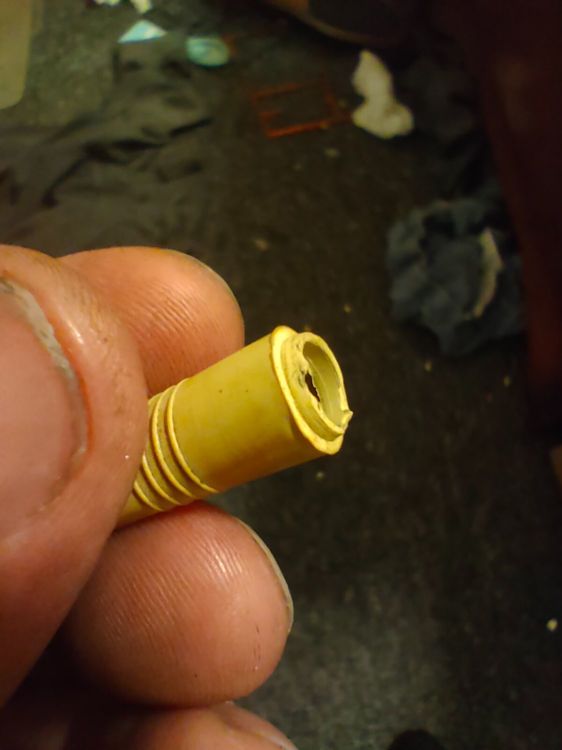

Ok, so I just did the tissue/paper test. That came flying out when I fired it, so I'm losing all my compression at the nozzle/bucking seal. Now in theory the new nozzle, it being longer, should give a better seal. But I'm guessing it might be a little thinner. either that or my bucking lips are shagged.
Maxx adjustable nozzle = your best friend.
This is probably the culprit, and the other bucking I used to test is an old knackered guarder black, that everytime I tried to install would slide further up the barrel meaning the lips wouldn't meet the nozzle. Im going to do armaments today so I'll put it all back together, bring the rifle and my chroni and pick up a fresh bucking. That's if anyone else thinks I could lose 200 fps just from the nozzle not reaching the bucking?
Yup, that'll do it.  The air is going to take the path of least resistance, and if that's down the feed tube, that's where it's going.
If the bucking is that knackered, it may also be blowing between the bucking and the outside of the barrel, although the Maple Leaf ridges are meant to (and seem to) give a better seal.  That's where PTFE tape might help though - I put it on for ritual purposes, and then silicone lube the outside of the bucking / inside of the hop to help it slide in.
