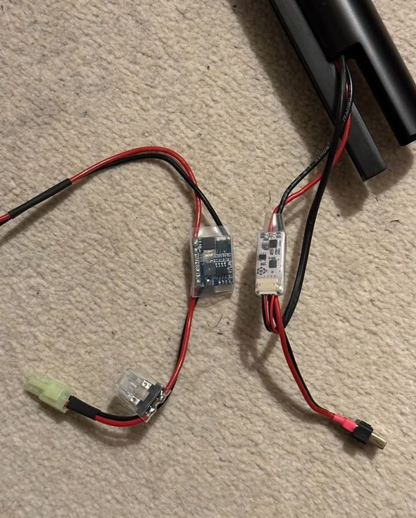

If you want more from a MOSFET than the standard offering you can swap to a Perun ETU++ pretty easily. It's outside the gearbox so is literally plug and play, I just had to remove the stock but I'm not sure about the AK as that's front wired so it may be a couple of extra screws.
I play CQB so have done mine, primarily for the pre-cocking but it also meant the battery connector changed from Tamiya to Deans.

Just looked it up and it looks decent but I’m limited on space so I will take a few measurements
It replaces the stock ETU and inline fuse so I found it made battery fitment easier. Not home at the mo so can't do a comparison, will have a go later for you.

Perun ETU++ on the right. G&G mosfet & fuse on the left.
I still need to tidy up the wires with a couple of cable ties - just need to find them first.

A Perun ETU++ is pretty much an essential upgrade to an G&G ETU-equipped gun.
Fitted one almost immediately after getting a G&G CM16 SRS for my son, really good bit of kit. Once the ETU trigger unit switches die, I'll replace the whole lot with a Perun Hybrid or whatever equivalent available at that time.
Should I just get a perun hybrid to start off with ?
No.
Whilst you will get a few more features on a full Perun Hybrid, you will have to open up the gearbox to fit it and the V3 version involves gluing bits to the selector plate. Easy enough if you've worked on a few guns and are happy to take it apart, but unless you have a spare gun or two (in case you cock up), I would suggest you leave well alone.
The ETU++ is simply plug and play - and will give you 90% of the features of the Hybrid in a smaller package than the stock G&G ETU.
You won't gain much switching out the hop units/rubber/nub/barrel on the higher-end G&G guns, they are pretty decent stock.
