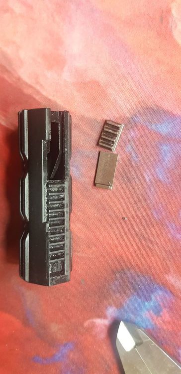

Yeah it needs new parts as the metal teeth on the piston have broke and the sector gear also. I believe it's a pre 2018 model so it's old and likely had plenty of use. When I got it it was firing at 320fps even with zero air seal. No idea how.
But after using it once. The piston teeth gave way. So I'm thinking I might just upgrade it with ASG ultimate piston and gears.
Have put a new o ring on the piston head and it seals perfectly and as for the shimming... well over 1mm of movement  on each gear is certainly not good. So I Also bought 3 packs of 100 shims at 0.1 0.2 and 0.3 mm for a 5er per pack. So much cheaper than buying from airsoft shops.
The sector gear took 1.6mm of shimming to make it sit nice.
But anyway as it's now a non runner figured i may aswell upgrade the parts that need replacing and put the newer 2020 mosfet in it too. Got it cheap anyway so happy to put some cash into it to get it running nicely.
