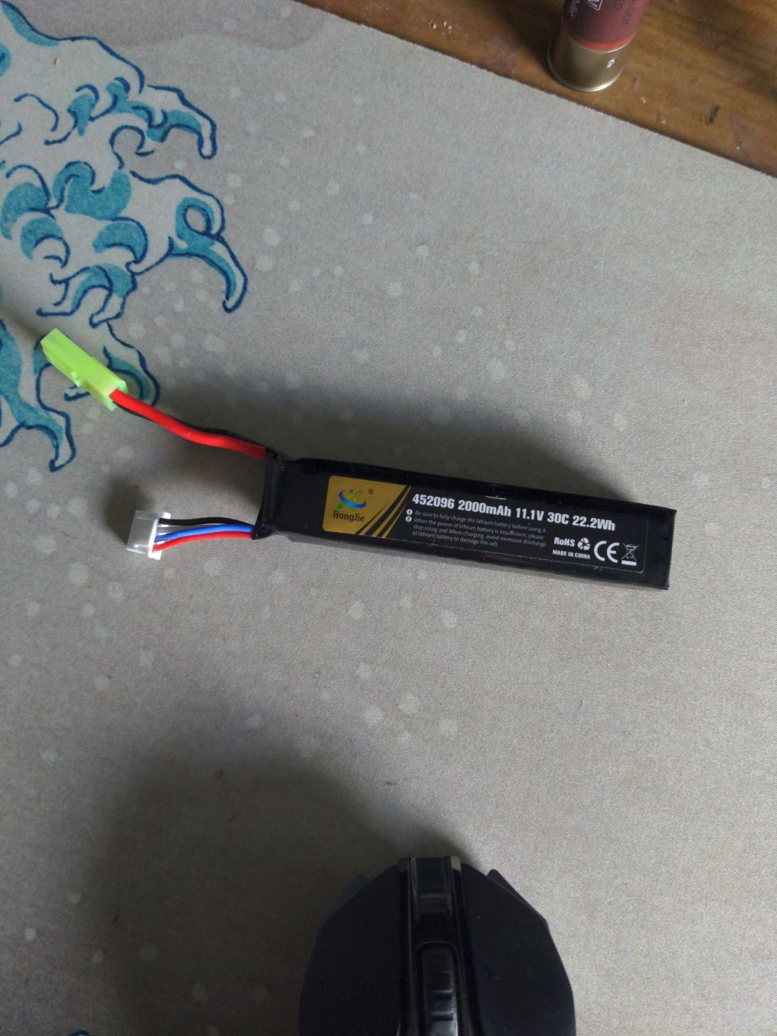

So after some testing the battery and charger are in spec, neither are fluctuating at all, both rock solid where they should be, the charger does say however after digging through the manual 2 and 3 cell lipos only, my battery has 4 so that is likely the cause although I don't actually understand how cells affect the ability to charge but here we are.
I'd hope not.  Lithium cells are (nominally) 3.7V each.  2 cell = 7.4V, 3 cell = 11.1V.  A 4 cell lipo or li-ion battery would be 14.8V.

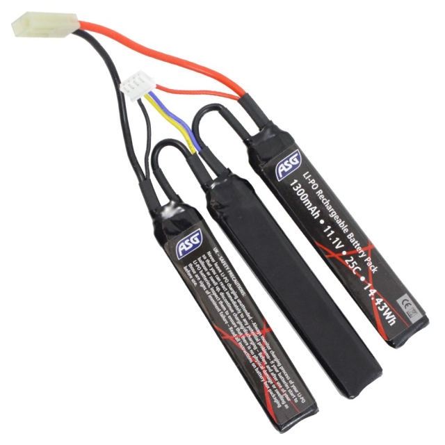

If you're looking at the number of terminals and wires on the balance port, that'll be cells+1, e.g.:
My cell is I believe what you call a block? Pictured below is what I have but as I stated it doesn't appear to be doing anything wrong. There's a video of the charging sequence too.
That's fine, it's a 3-cell 11.1V lipo.  Perfectly reasonable for airsoft use.
