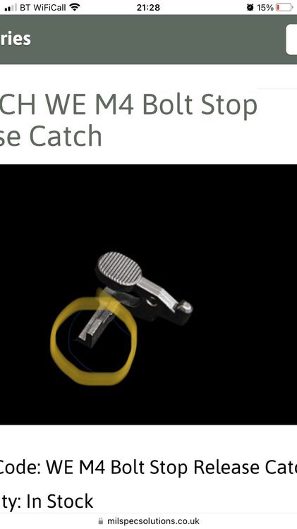

Try filing a coup millimetres off of the lug. This will help the bolt release sit higher.
Lovely I’ll give this a whirl, did you do this and still have the shims installed?
Yes. I forgot to put it in the earlier post.
