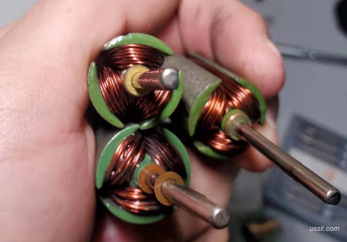

TPA:
Turn per Arm. The number of coils wound on the rotor, mainly affects the speed. Generally, the higher the number of turns, the lower the speed and the lower the heat generation. Many people like to use TPA to judge the performance of a motor, but this is not a scientific way. Don't worry, continue to read this article, I believe you will understand how to comprehensively judge whether a motor is suitable for you.

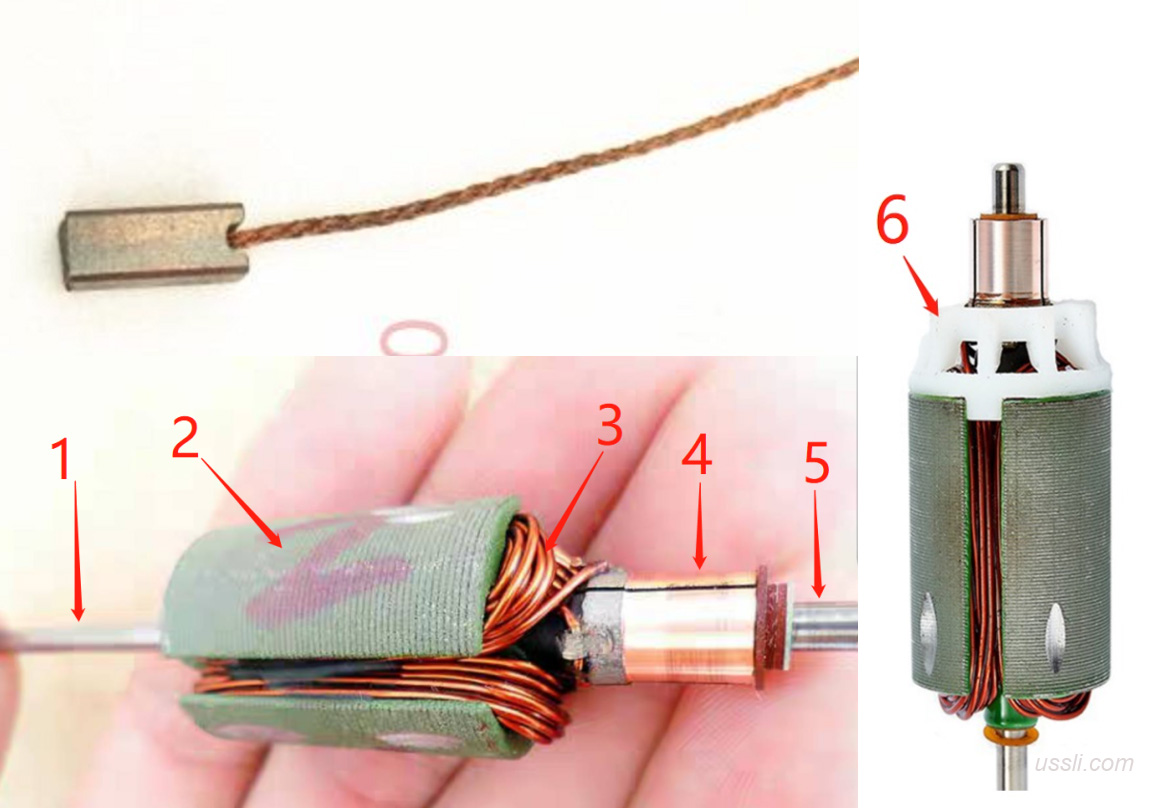

Rotor structure
  1. Rotating shaft
    Connectthe motor teeth, the heads are all D-shaped shafts
  2. Iron core
    Used to wind coils, generally made of silicon steel sheets.
  3. Coil
    Use enameled wire for winding. The thicker the wire diameter, the larger the current and the bigger the power. By the way, here is an explanation of the TPA and motor performance mentioned above. Under the same conditions, the larger the number of coils (TPA), the greater the torque and the lower the speed. The smaller the number of coils (TPA), the smaller the torque and the higher the speed. The upper performance of the gearbox is that high TPA can pull larger springs, but there will be lower RPS, and low TPA can obtain higher RPS, but cannot pull too high springs. At the same time, due to space constraints, if you want to get a higher TPA, you need to use a thinner wire, the current will be smaller, and the power of the motor will be lower, so the heat of the high-TPA motor will be relatively lower. We cannot blindly pursue high TPA or low TPA, we must choose the appropriate TPA according to the gears and springs (I recommend referring to the no-load speed of the motor to match the gearbox to obtain ideal performance, later I will talk about how to calculate and match)
  4. Commutator
    Contact with the carbon brush to supply power to the coil, which is a wear part, and can continue to be used by replacing the rotor after reaching the service life. However, the life of the commutator is usually much longer than that of the carbon brush, so the commutator can continue to work after the carbon brush is replaced several times (depending on the type of carbon brush).
  5. Base fixing shaft
    Fixed in the bottom cover to keep the motor axially stable. A good motor will use bearings to hold it in place to avoid wear and tear over long periods of time.
  1. Wind blade
    Some motors will install a plastic wind blade at the end of the iron core, which can drive the airflow to help dissipate heat when rotating,it is helpful for the motor that runs for a long time.
