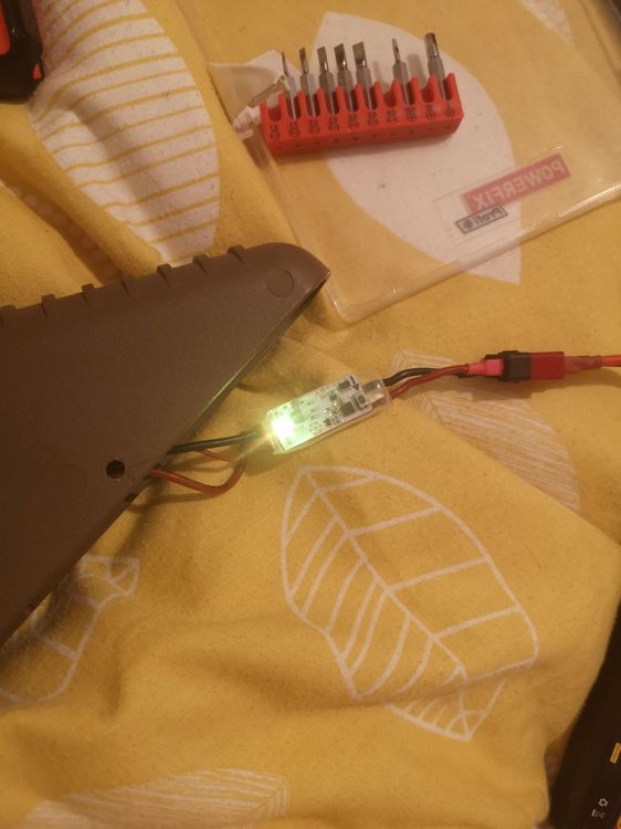

(The mosfet has yellow lights that blinks that says the motor is not connected. It turns green and make a beep sound if everything is in order)

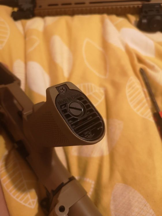

I opened the motor and check the connections and they are all fine. But when I close it the yellow lights blink when i connect it to the
battery. Or even just pushing it without the cover.
Now when I leave it open theres the green light and the beep, the motor works.
Im completely lost to whats the problem is. It might be the gears inside but i want to avoid disassembling everything if there is an easy fix.

It sounds to me like the motor is jamming up when motor housing is closed ?
Try undoing the screw in the motor cover a bit. Although it looks like it's already nearly out.
If you have a multi meter I'd check the wiring loom on the motor as well as the physical connection tabs. It could be something as simple as you pinched a cable and broken the wire, or the spade isn't staying put when the grip gets closed up.
If all is fine until the base plate goes on then start at the base of the motor and connections and work your way up as the perun yellow code is for motor connection not gearbox jam, which is a blinking red light usually.

I have done this and found out that the negative wire cuts off at a certain postion (when pushed down the gearbox). For some reason the disconnection happens just below the spade connector. So I had to crimp a new connector and soder it.
Thanks
It should be an easy fix but by Murphy's Law I made a stupid mistake.
I turn the motor on outside the pistol grip and all went to hell it spins so fast and hard that it broke the wires.
