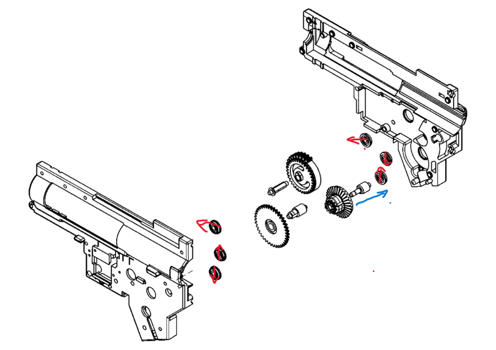

4 hours ago, Sewdhull said:
Only the bevel end of the Bevel gear bearings experience axial force, the bearings at the bevel end get an upwards radial force (1N) the other end a downwards radial force (3N). The axial force would be 2N on the bevel end.
How did you calculate the 3N on the other side? And the 2N axial force?
For a bevel gear the axial force is around double the radial force, which I took as 1N so axial force is 2.
The calculations are done on the linked gear page.
The 3N is derived from the interaction of the Middle gear and Bevel gear 3 to 1 ratio multiplying the tangential forces and proportionately increasing the radial force.
It should be noted that gear tooth geometry affects the forces, the pressure angle in particular, but a little research indicates that the numbers on the linked page are typical.
Edited by Sewdhull
Changed axial to radial
It seems your forces are going "one way" from the motor, what about the spring load coming back, does it apply any load on the bevel gear and does it modify the radial load directions?

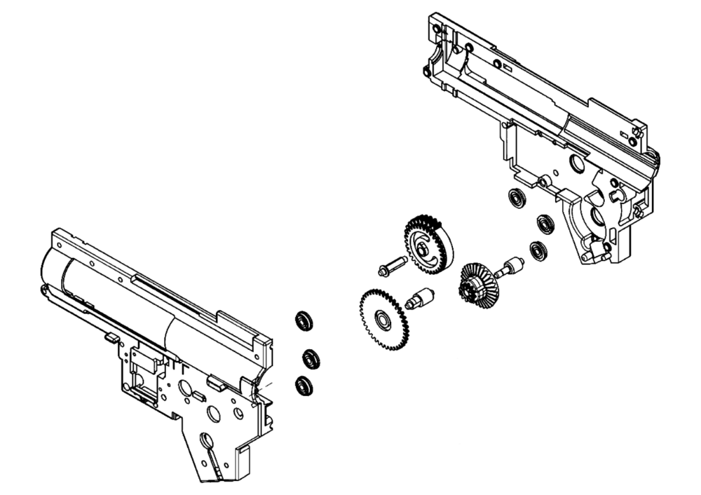

For sake of my understanding do you mind drawing some arrows on this diagram?
The forces get resolved for each gear and they originate at the motor.
Forces balance, the tangential forces that spin the gears only do so because there's more motor force than needed to compress the spring. The axial and radial forces balance at each bearing.
The forces originate at the motor pinion and build depending on the load the gears eventually connect to. The gear teeth meet at an angle which produces the radial and axial forces dependant on the gear types and gear shape.
I think that's right altho i am just starting my 5th night shift. Remember these are not forces of the gears pushing against each other, they dont as they at times not in contact with each other. The forces are created when the gear teeth mesh at an angle and push at an angle creating forces in 2 or 3 directions.
The down arrow for the Middle gear i wrong, it should be up.
Edited by Sewdhull
