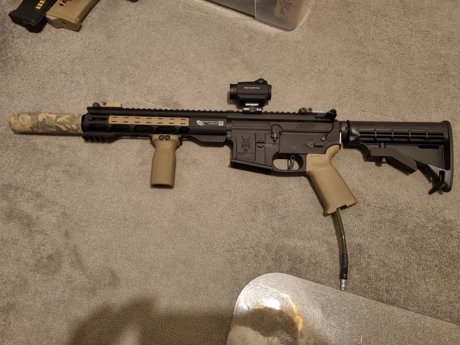

A sneaky pic of the latest addition attached...

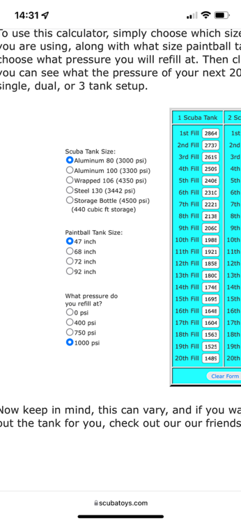

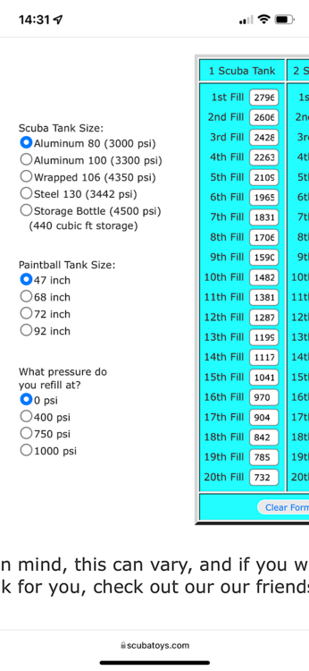

For the number of fills, this doesn’t give the right options, but is a really good guide.
Second hand scuba will be fine, hydro tested shows it’s all good.  Just have a nose at the markings
From new you have x years until it needs a test, then the test periods
For second hand that’s the same, but if it was untested and had been sat depressurised and damp then a tester could fail it
I’m not fully on board for all scuba rules, they can have shorter test cycles (as they expect to keep breathing) but there have been the options of ‘surface use only’ markings - it that can be applied then you can have a longer cycle between hydro tests
https://www.scubatoys.com/paintball/scubafills2.asp
The scuba sizes they list are in American, I think the ‘Scuba 80’ is equivalent to a 12 litre
A run through clicking the options will give a guide.  Whenever a fill level is higher than you want, just stop and you next fill will be able to get more
The highest it lets you choose is to refill at 1000, but in airsoft you should be using less air per shot than paintball, and can refill more often
(Always use the site air station when you can to save on your scuba - and if possible get a last fill before they shut it down at the end of the day)
