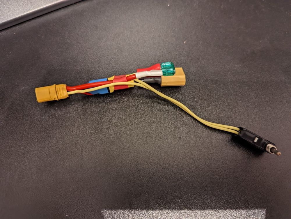

Ok, I think this will work. I've made a double switch from a miniature toggle switch and a microswitch. So you have to throw the toggle before you can press the switch. This should prevent any accidental firing (I will also fit a shield over the microswitch). I make all my MOSFETs modular so you can swap them out if there are any issues.
It works as expected, flick the switch, press the button and it cycles. I'll have to wait for it to lock again to fully test it, but this sure beats having to take the top reciever off any try and poke the cutoff lever with a screwdriver....

That's a great job.  I was thinking more a couple of bare wires loosely wrapped in electrical tape.
