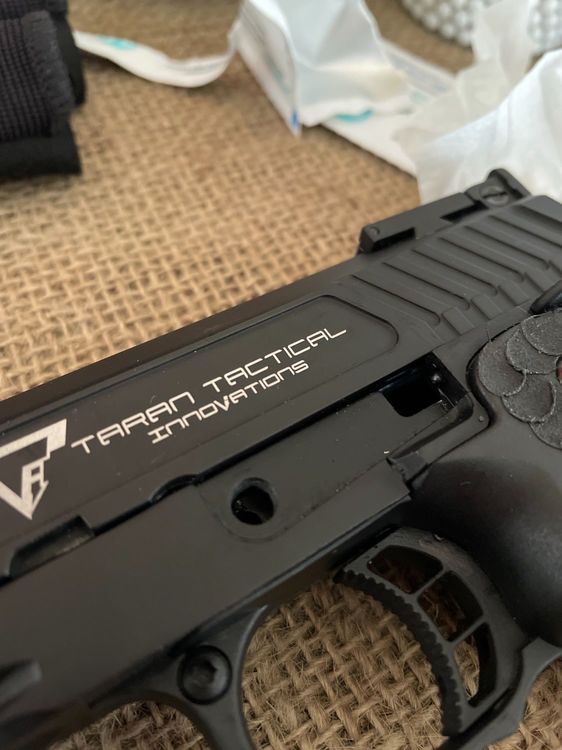

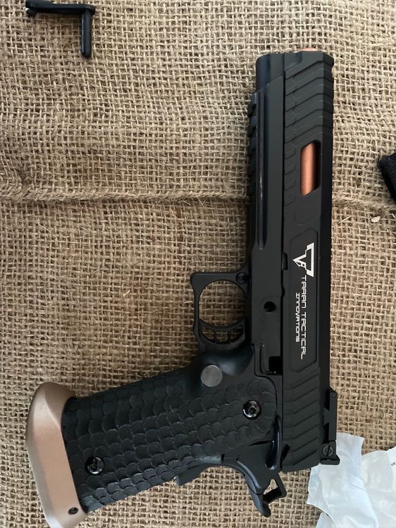

Dylan8 Posted October 30, 2021 Posted October 30, 2021 Hi guys so my Hi capa isn’t locking back when the mag is empty, any hep is appreciated i think slide release is worn maybe? it’s brand new…

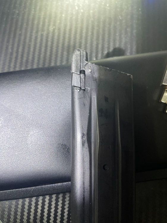

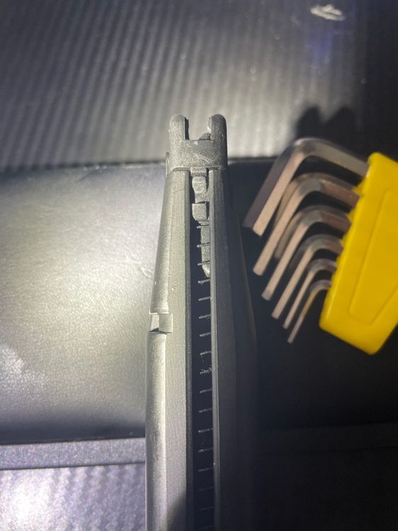

Guest Posted October 30, 2021 Posted October 30, 2021 Wedge the bb follower as high as it will go in the mag, then manually pull the slide back. You said you took it apart, and you’re not fully conversant with GBB pistols, are you sure you have re-assembled it correctly? You said it’s standard, but I don’t believe that magwell is?
hitmanNo2 Posted October 30, 2021 Posted October 30, 2021 With the slide off and an empty mag in, does the follower push up on the slide stop? If so, that will rule out mag, spring, follower and slide stop issues and narrow it down to the slide stop/slide notch interface.

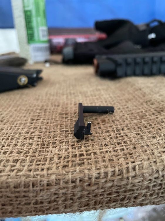

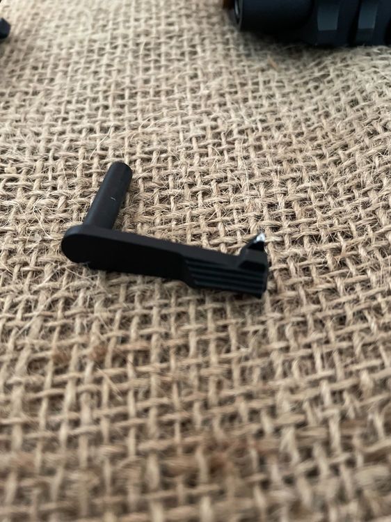

Dylan8 Posted October 31, 2021 Author Posted October 31, 2021 I think it’s something to do with the slide release bolt that I showed pictures of causing the issue, taking it in to the shop on Monday and will update what the issue really was. thanks for your tips I appreciate the help
leadly Posted October 31, 2021 Posted October 31, 2021 Are you inserting the slide catch pin back in with the slide pulled back far enough, so the "pointy bit" of the pin (that's missing a bit of paint) sits in the smaller of the 2 notches in your slide?
Steveocee Posted October 31, 2021 Posted October 31, 2021 I fixed this for a guy at hells a few months ago, was the follower in the mag not pushing up far enough.
Guest Posted October 31, 2021 Posted October 31, 2021 37 minutes ago, Steveocee said: I fixed this for a guy at hells a few months ago, was the follower in the mag not pushing up far enough. thats what I think. If it’s marginal, it might be the magwell stopping the mag inserting properly, and thereby stopping the bb follower raising enough

Guest Posted November 1, 2021 Posted November 1, 2021 44 minutes ago, Dylan8 said: taking it all to a shop tomorrow to see if it can be fixed It’s just the spring being compressed too much, take it our, stretch it, don’t store your mags loaded
Dylan8 Posted November 2, 2021 Author Posted November 2, 2021 The issue is to do with the slide release part. A new part from a different hi capa would fix the issue however there was some movement when the magazine entered pushing the release part out a small bit causing you not to be able to press the slide release unless you push in inwards.
